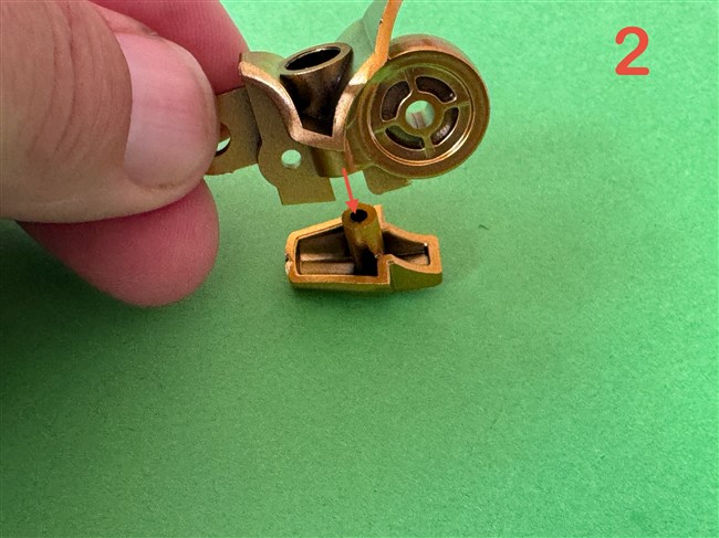

Attach the claw joint to the claw joint detail by using a type E screw, pictures 2, 3 and 4.
