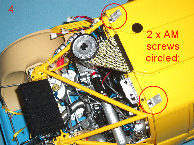

STAGE 101:
Rear Body.
Pic 1: Undo the screws indicated and remove the support strap on the body 101A.
Pic 2: Assemble the hinge parts 101B, 101C and 101D as shown.
Pic 3: Make two sets.
Pic 4: Fix the hinges to the roof of the car using 1 x AM screw in each.
Pic 5: Open the car bonnet and fit the spoiler 101E as shown.
The part is not a tight fit so you may wish to use small dots of adhesive on the locating pins.
Store the model and unused body part safely.
