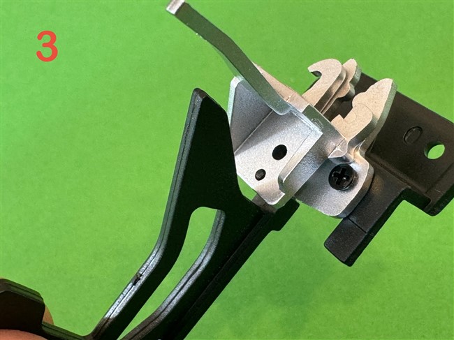

Hood/Bonnet Lock
Picture 1 show the parts for this issue.
Start the assembly by aligning the two hood parts together as shown in picture 2 and secure the two parts together using 2 x D screws. Fit the lower hood lock and secure it to the assembly using a I type screw, pictures 3 and 4.
Picture 5 shows the assembly complete for this issue.

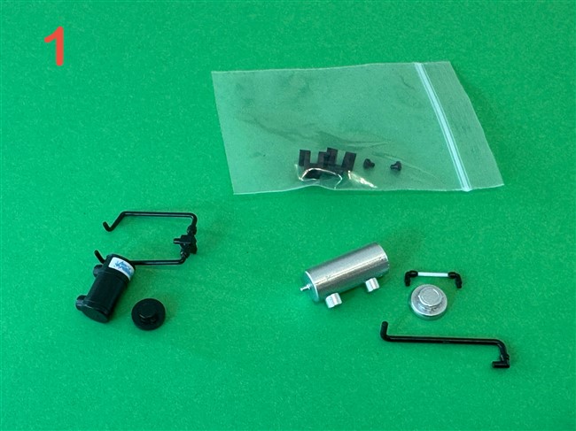

Issue 86
Vacuum Tank and Air Conditioning Filter.
Start by fitting the two rubber bumpers to the mounting brackets, picture 2.
Press fit the vacuum tank top to the vacuum tank, picture 3. Attach the vacuum tank ducts into the top of the tank, picture 4.
Press the air conditioning top into the filter unit, picture 5. Fit the two ends of the level pipe into the two holes on the side of the filter, picture 6. Note: I used a spot of glue to hold it in place.
Finally, insert the filter pipe into the hole in the top of the air conditioning filter, picture 7.
