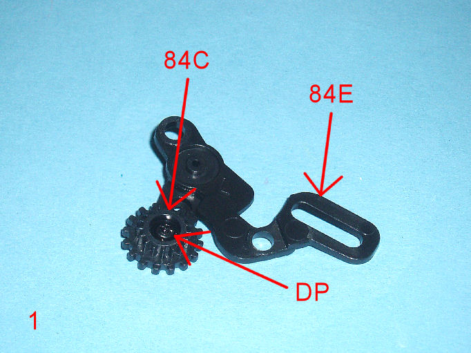

Pic 1: Fit the window mechanism parts 84C and 84E together as shown and fix with 1 x DP screw.
Pic 2: Fit the lever 84D in place as shown and fix with 1 x DP screw.
Pic 3: Fit the regulator arm 84F as shown and fix with 2 x DP screws.
Pic 4: Fit the window 84A to the assembly and fix with 2 x JP screws.
Pic 5: Retrieve the door panel83A and fit the window and mechanism as shown.
Fix with 2 x DP screws and 1 x AP screw.
Pic 6: Retrieve outer door 82A and fix the hinges 84B as shown using 2 x GM screws.
Pic 7: Fit the inner and outer door panels together and fix with 5 x QM screws.
Check the window operates correctly by turning the wheel at the bottom of the door.
Store safely for now.

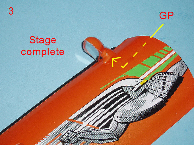

STAGE 86:
Right door 1.
Pic 1: Fix the door handle 86B to the door 86A with 2 x AP screws from behind.
Pic 2: Peel the backing from the mirror 86C and stick it onto the mirror body 86C.
Pic 3: Fix the mirror to the door with 1 x GP screw from behind.
