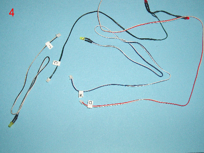

STAGE 106:
Air intake and right wheel well.
Pic 1: Fit the air intake parts 106A and 106B together as shown.
Pic 2: Fit the air intake parts 105A and 105B together as shown.
Pic 3: Fit 105A into the upper rear body where shown and fix with 1 x AP and 1 x AM screws.
Pic 4: Retrieve the rear lights ‘C’, ‘D’ ‘J’ and ‘K’.
Pic 5: Fit LED ‘K’ where shown.
Pic 6: Fit the 2 x LED’s ‘D’ where shown.
Pic 7: Fit LED ‘J’ where shown.
Pic 8: Fit the 2 x LED’s ‘C’ where shown.
Pic 9: Run the cables under 106A as shown and fix with 1 x AM and 1 x AP screws.
Pic 10: Store everything safely for now.

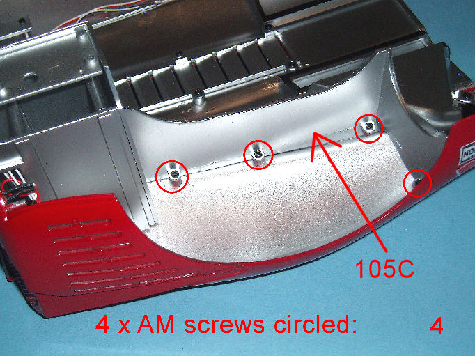

STAGE 107:
Trunk partition and light housing.
Pic 1: Locate the partition parts 107A and 107B.
They will press-fit together.
Pic 2: Parts assembled.
Pic 3: Fit the assembly into the rear body as shown, noting where the light wires exit.
Fix with 2 x AM and 1 x AP screws.
Pic 4: Fit the wheel well 105C in place and fix with 4 x AM screws.
Pic 5: Tuck the LED wires behind the partition.
Store the body and unused parts safely.

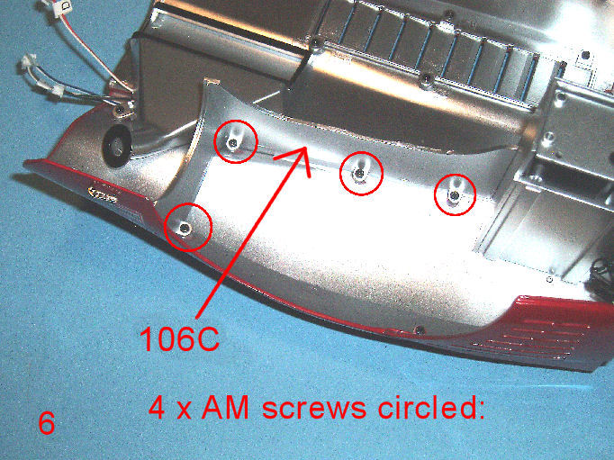

STAGE 108:
Pic 1: Locate the partition parts 108A and 108B.
Pic 3: Route the wires at the rear along the body as shown and fix with a strip of tape 108D.
Pic 4: Fit the assembly into the rear body as shown, noting where the light wires exit.
Pic 5: Route the wires along the inside of the body as shown and fix with strips of tape 108D.
Pic 6: Fit the wheel well 106C in place and fix with 4 x AM screws.
Pic 7: Tuck the LED wires behind the partition.

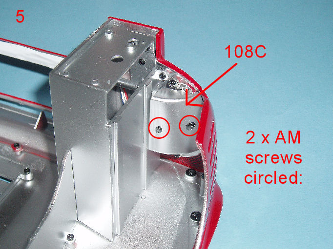

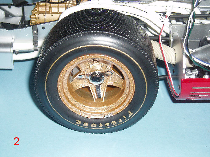

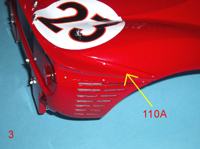

STAGE 110A:
Right hood components and completion.
Pic 1: If you have not already done so you can fit the wheels now using the parts saved.
Pic 2: Rear wheels fitted.
Pic 3: Fit the rear wing 110A to the rear body.
Pic 4: Fix from inside with 2 x UM screws.
Pic 5: Fix the light cover 108C using 2 x AM screws.
