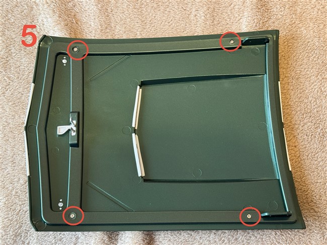

Issue 105
Hood
Place the inner reinforcement on the underside of the hood and make sure that the four protrusions on the hood fit snugly into the holes in the reinforcement. Fix the reinforcement to the hood with four DS35 screws as shown in picture 2.
