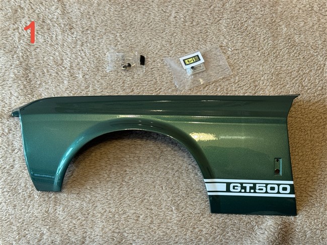

Issue 106
Left Front Fender
Separate this sticker with the emblem (106C) from its backing. Attach the sticker to the emblem base (106B), picture 2. Now attach the emblem to the rear side of the left front fender as shown in picture 3.
Turn the assembly over and fix the base with a PS17 screw from the inside, picture 4.
Pictures 5 shows the final assembly for this issue.

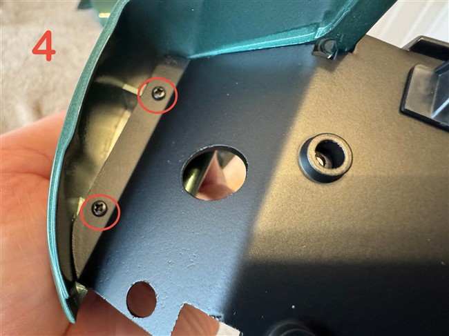

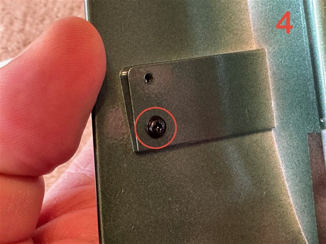

Issue 108
Right Front Fender
As you did in issue 105, attach the emblem base (108B) to the rear of the right front Fender (108A), picture 2.
Retrieve the chassis front panel. Put it alongside the right front Fender so you can see where the two parts are attached, picture 3. Fix the panel to the Fender using 2DS10 screws through the front of the assembly as shown in picture 4.
Now retrieve the left front Fender and position it in the same way as the right front Fender. Secure it in place using two DS10 screws, picture 5.
