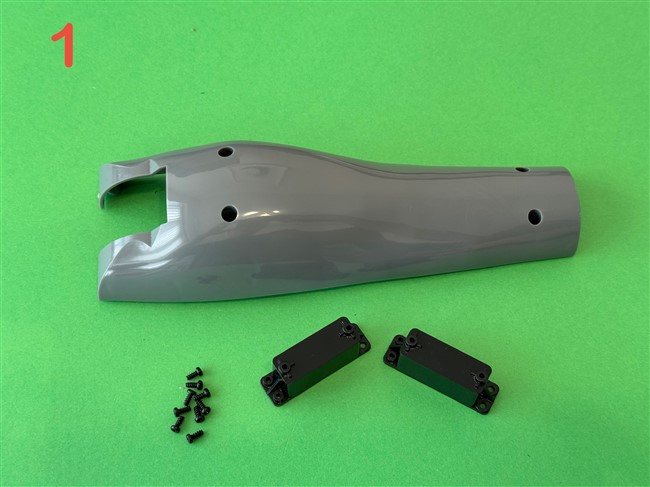

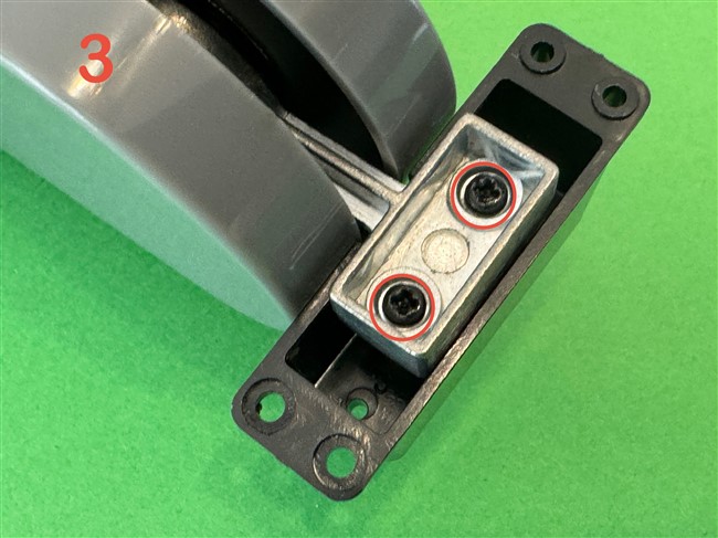

Issue 80
Right Leg
Fit the holes of the female strap (80-03) into the two upper left holes inside the right shin armour, picture 2. Place one of the plate washers over the holes and secure in place using 2 x x screws, picture 3.
Now do the same with the other straps as illustrated in picture 4. Note: the packaging the individual straps come in are clearly marked with their part number for identification.
Picture 5 shows the assembly stage complete for this issue.
