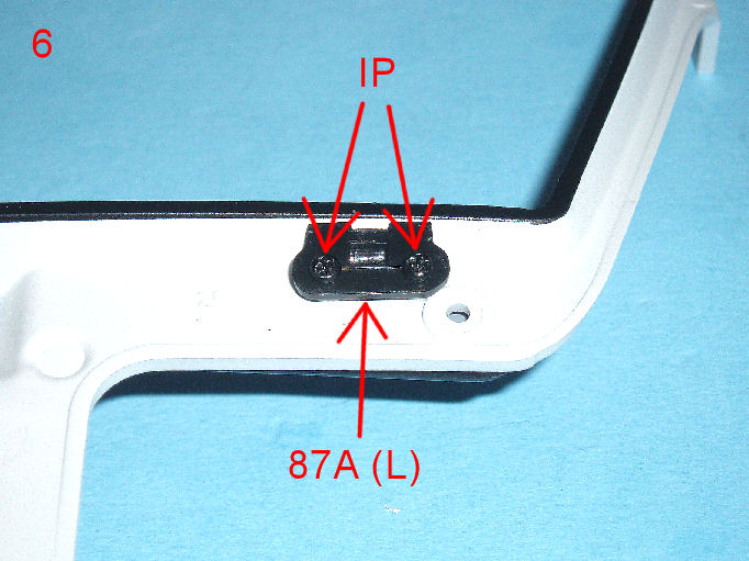

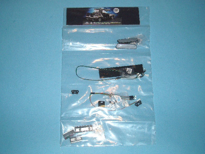

STAGE 87A:
Roof interior.

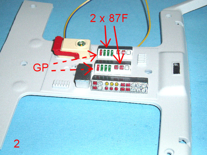

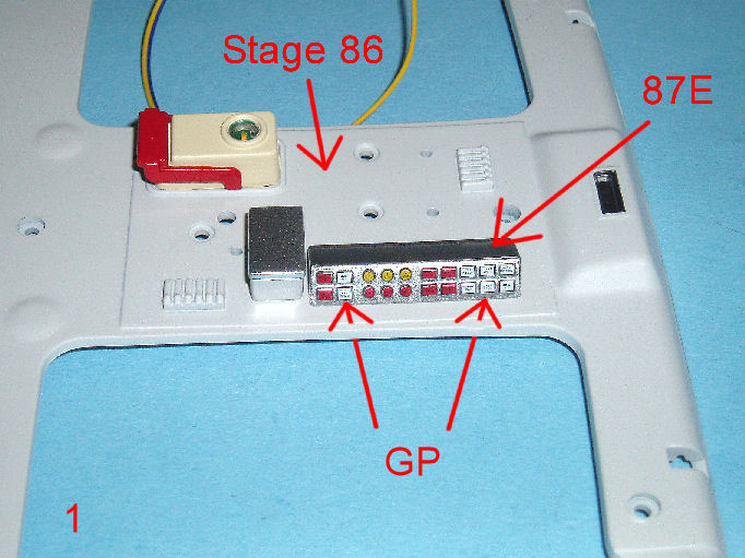

Pic 1: Fix the large panel 87E to the roof lining with 2 x GP screws underneath.
Pic 2: Fix the 2 x smaller panels 87F with 1 x GP screw in each from underneath.

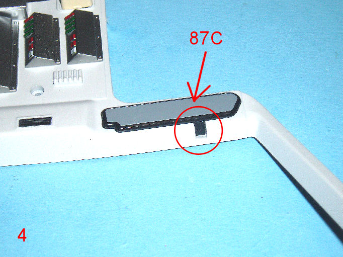

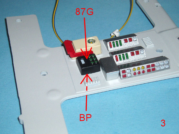

Pic 3: Fix the black box 87G with 1 x BP screw underneath.
Pic 4: Fit the left sun visor 87C as shown.

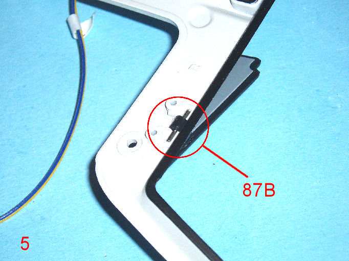

Pic 5: Fit the hinge pin 87B where indicated.

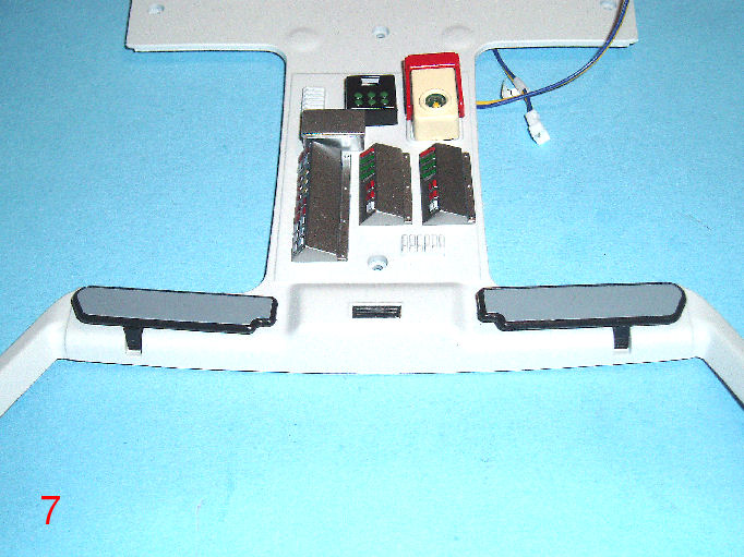

Pic 6: Fix the retainer 87A (L) with 2 x IP screws.
Pic 7: Repeat on the other side with the right hand parts.

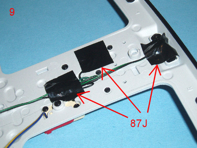

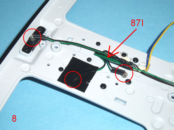

Pic 8: Fit the 3 x LED’s 87I on the inside of the roof lining as shown.
The black tape 87J over the central LED is to hold it in place as it is a very loose fit.

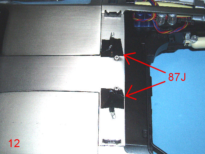

Pic 9: Fix tapes 87J over all of the LED’s.

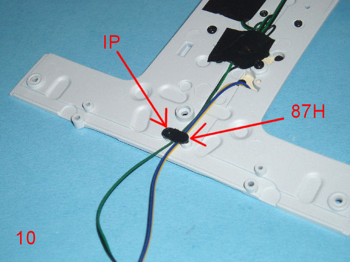

Pic 10: Fix the wires at the rear of the roof lining using the tab 87H and 1 x IP screw.

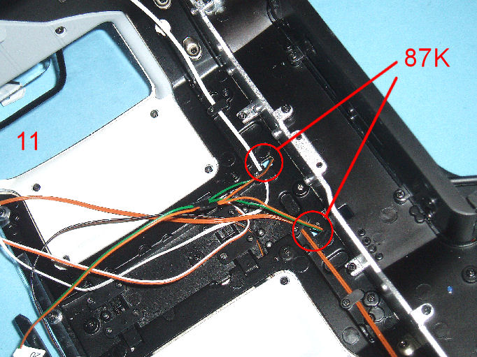

Pic 11: Feed the 2 x LED’S on wire 87K through the holes in the car roof where shown.
Pic 12: On the outside, tape the LED’s down with 2 x 87J.

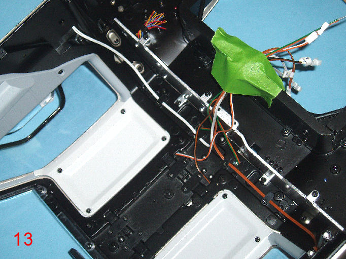

Pic 13: On the inside of the car, secure all of the wires out of the way at the rear.

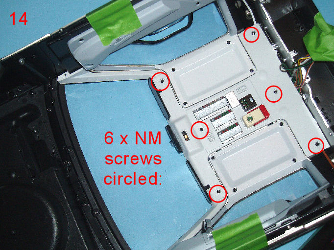

Pic 14: Fit the roof lining in place and fix with 6 x NM screws.

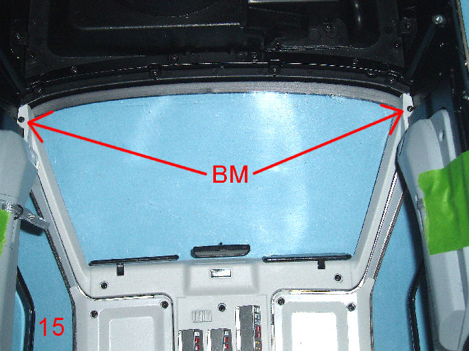

Pic 15: Fix the front screen pillars with 2 x BM screws.

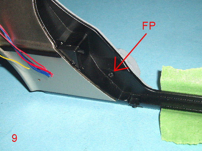

Pic 8: Open the driver’s door and fix the inner panel with 1 x FP screw where shown.
Pic 9: Repeat on the other side.

Pic 15: Feed the long yellow/orange wire through the hole in the engine surround as shown.
NOTE – The printed instructions incorrectly label this wire yellow/red.

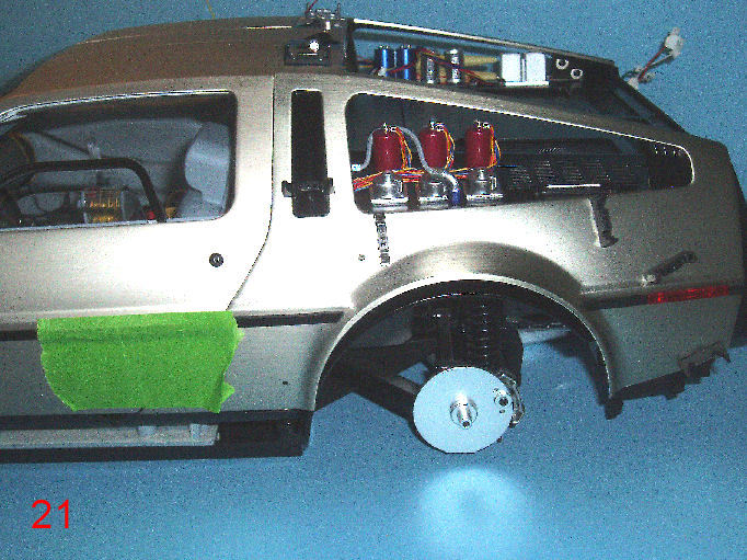

Pic 23: Turn the assembly over and carefully press down at all wheel arches until you hear the body click into place.
Fix the central area with 4 x RM screws.
Pic 24: Fix with another 2 x RM screws at the rear.
