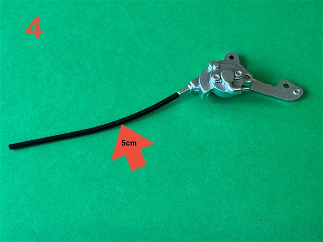

Issue 43
First, cut two pieces of cable from the cable supplied, one piece cut at 5cm and the other at 7cm, pictures 2 and 3.
Place the 5cm cable on the end of the throttle linkage as shown in picture 4, and the 7cm cable on the other pin of the throttle linkage, picture 5.
Place the throttle linkage onto the front face of the upper fork and secure it in place using 2 x KM screws, picture 6.
Take the shorter cable from the throttle linkage and place it onto the pin on the control, picture 7.
