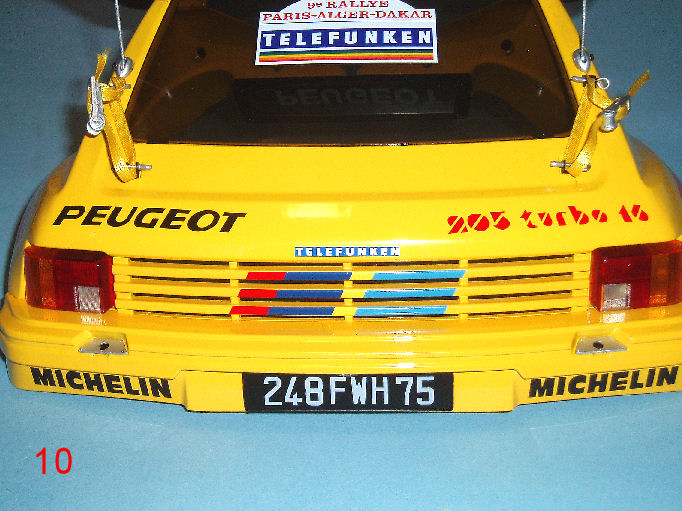

Pic 1: Retrieve the rear body and fit the tail lights 105B and 105D as shown.
Fix from behind with 2 x AP screws in each.
Pic 2: Press-fit the light covers 105C and 105E.
Pic 3: Turn the assembly over and fit the grill 105A as shown and fix with 3 x AM screws on the inside.
Pic 4: Fix the bumper from stage 104 as shown using 5 x AM screws.
Pic 5: Store safely for now.

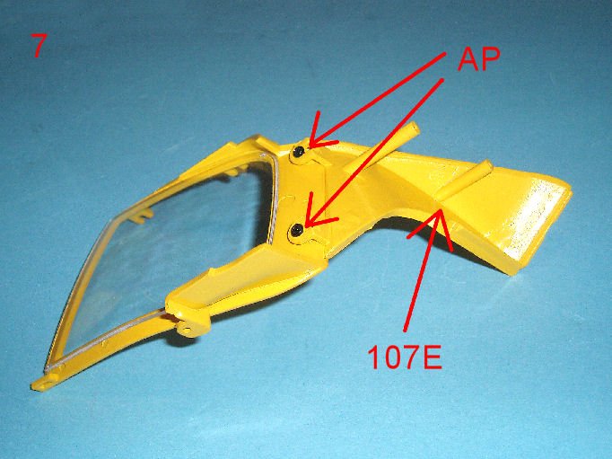

Pic 1: Choose which window glass you wish to use – 107A or 107B.
Press-fit the glass into the frame 107C.
Pic 2: Fix the air intake part 107E to the frame using 2 x AP screws.
Pic 3: Fix the outer panel 107D to the assembly with 2 x AP screws.

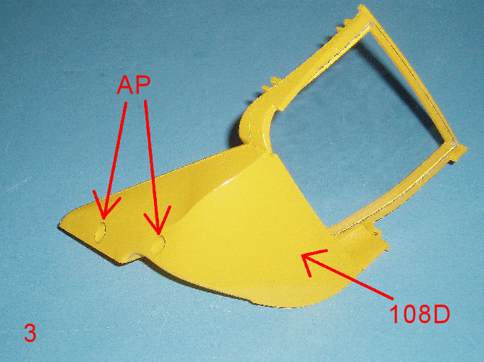

Pic 1: Choose which window glass you wish to use – 108A or 108B.
Press-fit the glass into the frame 108C.
Pic 2: Fix the air intake part 108E to the frame using 2 x AP screws.
Pic 3: Fix the outer panel 108D to the assembly with 2 x AP screws.

Pic 1: Fix the 4 x brackets 110D to the rear body using 1 x QM screw in each.
Pic 2: Cut 4 x pieces of 3mm tube from 110J.
Pic 3: Fit the retaining pins 110E to the brackets and fit a 3mm piece of tube 110J over the other end to secure them.
Pic 4: Fit the belt 110G through the buckle 110F as shown.
Fix a sticky tab 110K where indicated.
Pic 5: Peel the backing from the tab and wrap the belt around, sticking it down to the tab.
Pic 6: View from the other side.
Pic 7: Make 2 x sets.
Pic 8: Feed the belt down through the brackets on the rear of the body.

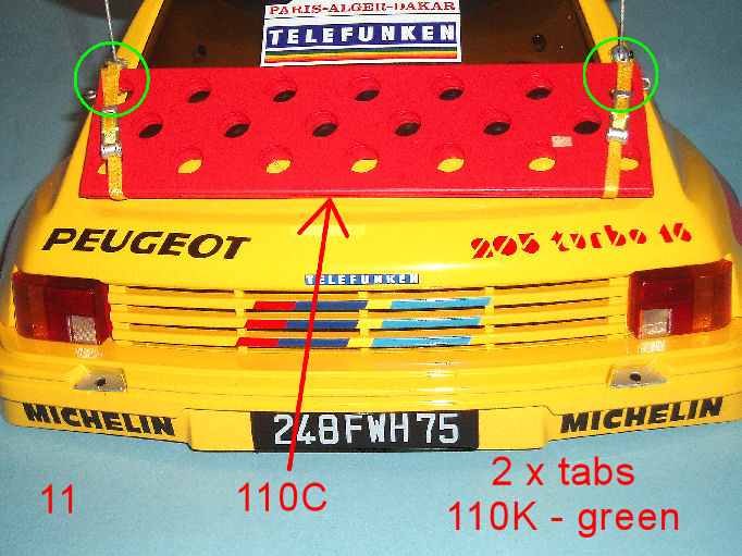

Pic 9: Pass the lower end of the belt up and through the buckle as shown.
Pic 10: Repeat on the other side.
Pic 11: Fit the traction boards 110C in place and pull the belts tight.
Fix the loose end of the belt using 1 x tab 110K on each.

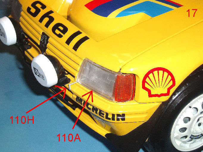

Pic 17: Fit the light covers 110A and the pins 110H as shown.
Repeat on the other side of the car.

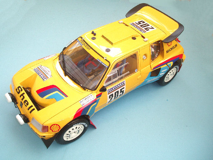

CONGRATULATIONS!
You have now completed your Peugeot 205 turbo 16.
Display it with pride!
