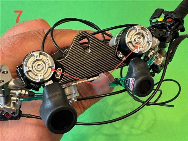

Issue 44

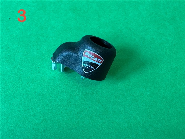

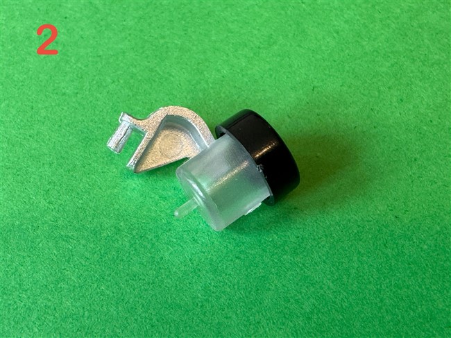

Place the reservoir cap onto the clutch lever fluid reservoir, picture 2, then add the cap cover, picture 3.

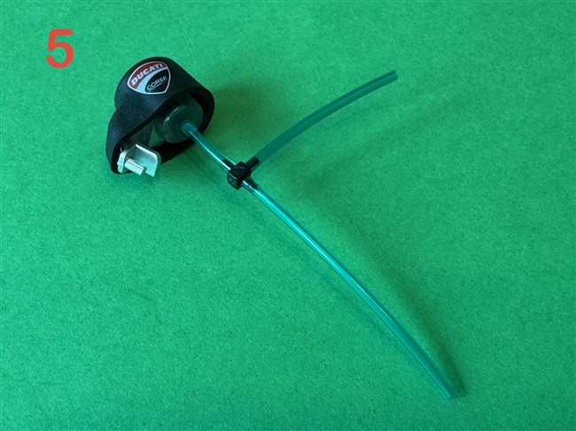

Cut the transparent tube into three pieces, 4cm, 2.5cm and 1cm long. Connect the tubes to the three-way connector as illustrated in picture 4. Place the 1cm end to the clutch reservoir as shown in picture 5.
Place the reservoir to the folk assembly on the opposite side to the brake fluid reservoir. Attach the remaining two tubes as illustrated in picture 6.
Finally, attach both fork shock absorber heads by simply pressing them both in place, picture 7.
Picture 8 shows the assembly complete for this issue.
