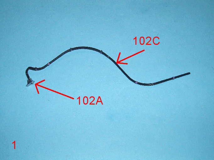

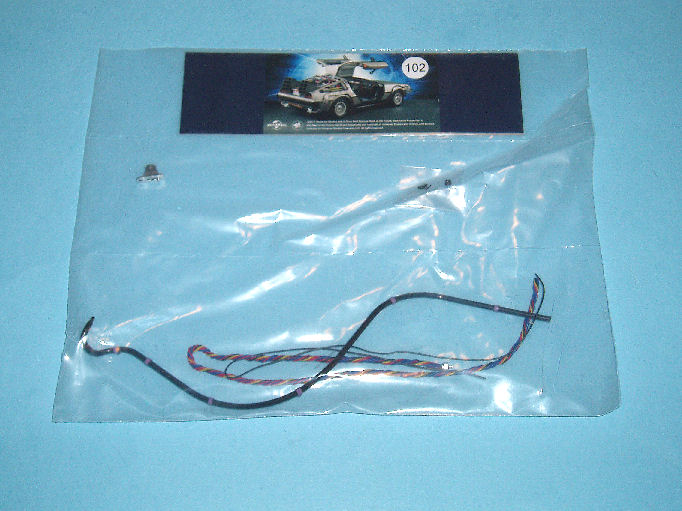

STAGE 102:
Cables, wires front right.
Pic 1: Attach the fitting 102A to the end of the cable 102C.
Pic 2: Fix the fitting to the left power box with 1 x IP screw.
Attach the cable to the side of the car with the pins/locating holes.
Pic 3: Connect the wires 102D to the power box as shown.
Using pieces of the wire 102D, attach the coloured wires to the cable at intervals by twisting the wire around them. Trim off any excess.
Store the car safely for now.

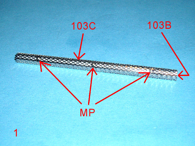

Pic 1: Locate the mesh 103C.
As before, wrap the mesh around the tube 103B and fix with 3 x MP screws when you have the holes in the mesh and the tube aligned.

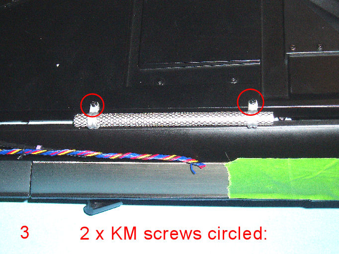

Pic 3: With the car upside down, fix the tube to the right side using 2 x KM screws.

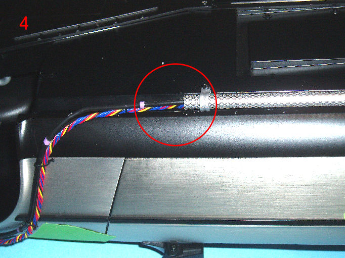

Pic 4: Fit the black cable and bunch of wires at the front of the car in the same way as before, after trimming the coloured wires shorter.

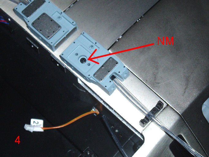

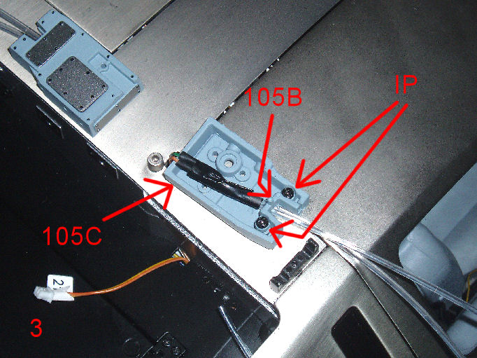

STAGE 105:
Junction box top right.
Pic 1: Remove the tape holding the top left LED in place.
Pic 2: Fit the 2 x filaments 105A up against the LED and wrap them with the sticky tape 105E as shown.
Pic 3: Place the junction box 105C upside down under the filaments/LED.
Fix the retaining bracket 105B in place with 2 x IP screws.
Pic 4: Turn the junction box over and fix it to the roof with 1 x NM screw.
Pic 5: Press-fit the cover 105D in place.
Fit the filaments into the first bracket as shown.
Store safely for now.
