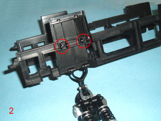

STAGE 57:
Front chassis.
Pic 1: Fit the suspension assembly from stage 54 to the chassis 57-1 as shown.
Pic 2: Fix the parts with 2 x D screws.
Store safely for now.

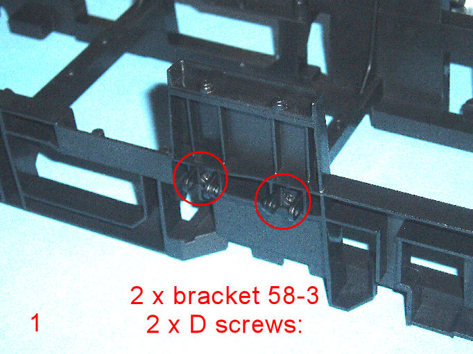

STAGE 58:
Front suspension 2.
Pic 1: Fix 2 x brackets 58-3 to the front chassis as shown with 1 x D screw in each.
Note the raised side of the bracket faces inwards.

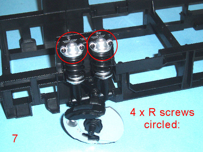

Pic 7: Fix the shock absorbers in place with 2 x R screws in each.
