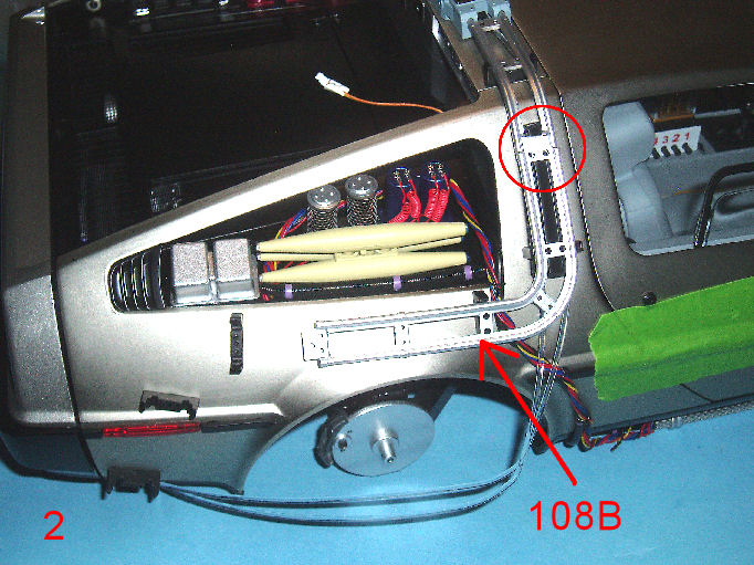

Pic 2: Fit the filaments into the lower bracket on the side of the car and then add the frame 108B.

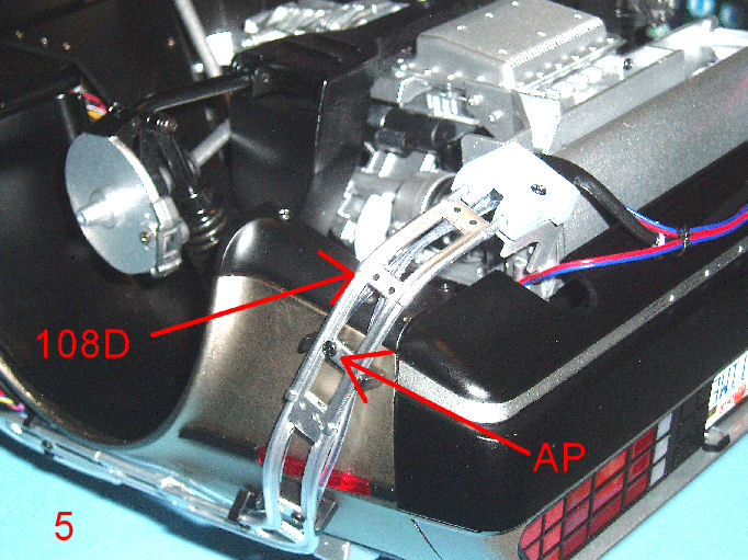

Pic 5: Turn the car over and fit the frame 108D s shown, trapping the filaments in the bracket.
Fix with 1 x AP screw.

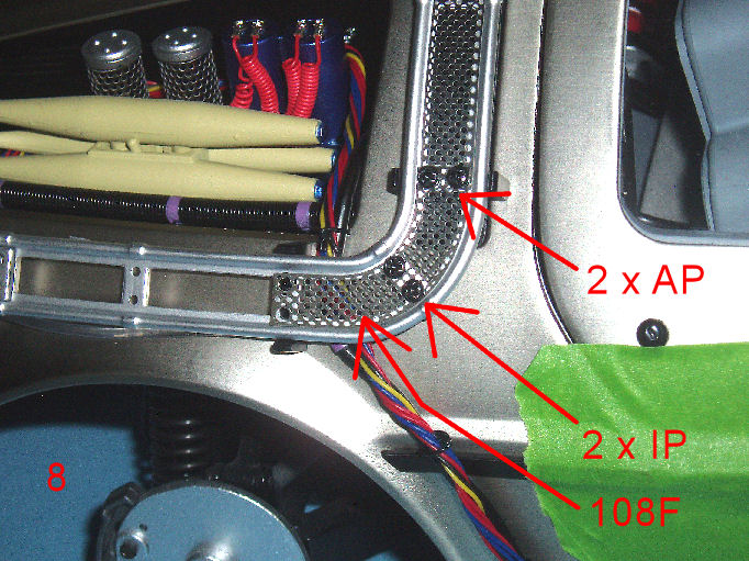

Pic 8: Fit the curved grille 108F and fix where shown with 2 x AP screws and 2 x IP screws.
