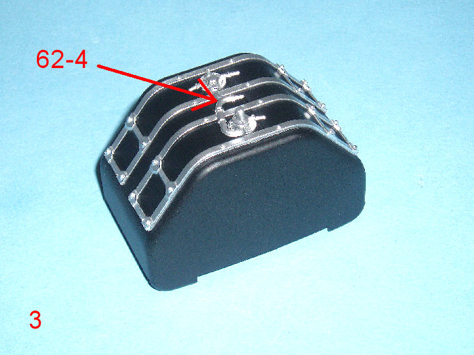

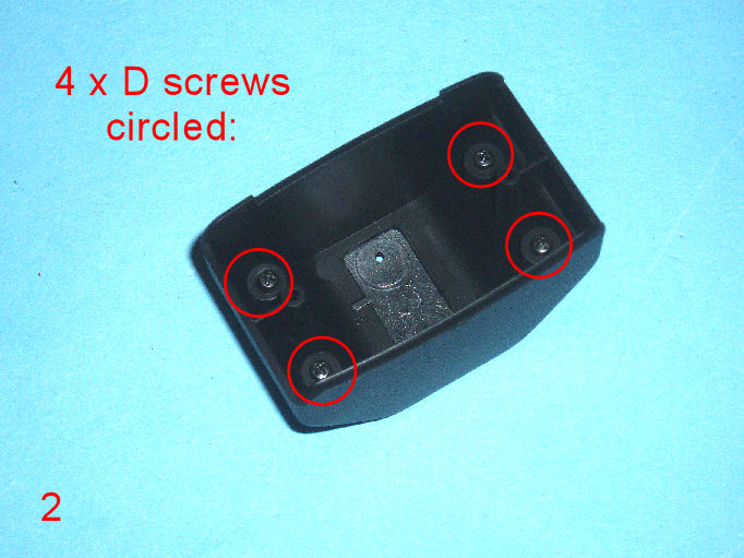

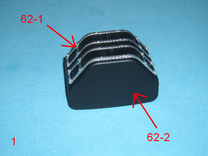

Right fuel tank.
Pic 1: Fit the tank parts 62-1 and 62-2 together as shown.
Pic 2: Fix from underneath with 4 x D screws.
Pic 3: Press-fit the tank fittings 62-4 in place.
They will only fit one way.
Pic 4: Fix the tank base 62-3 in place with 2 x D screws.
It will only fit one way.
Store safely for now.
