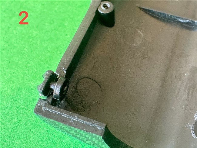

Place the small grommet into the right fairing inner half, picture 2.

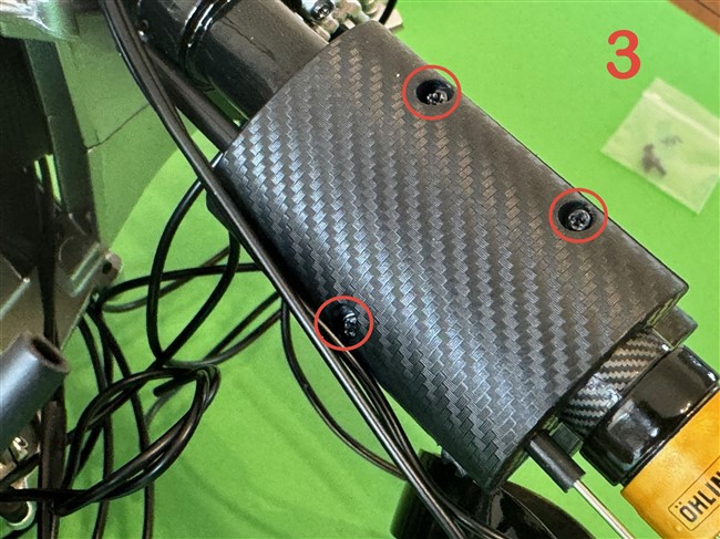

Fit the right fairing inner halves to the left fork and secure them both in place using 3 x KP screws, picture 3. Note: these will only fit one way.

Picture 5 shows the assembly complete for this issue.
