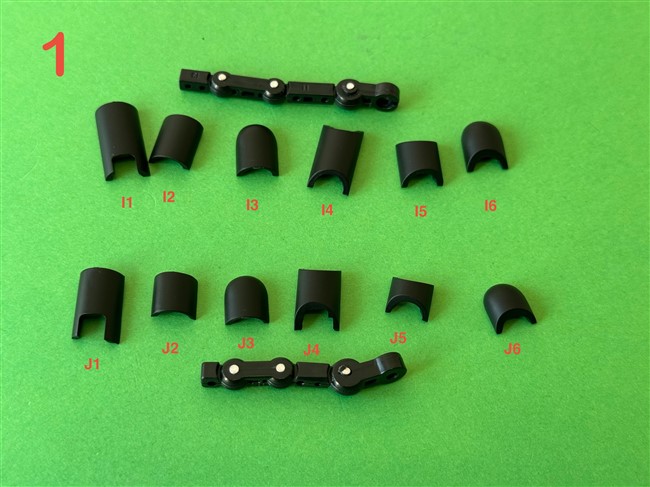

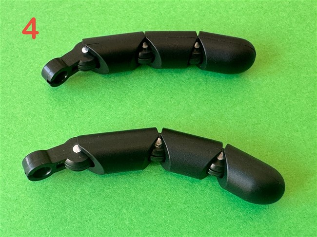

Issue 83
Picture 1 shows the contents of this issue. It also shows the parts in order of assembly.
Right Index and Middle Finger
As you did with the previous hand, identify all the index finger segments. Take the index structure and place the first top three segment by push fitting the parts in place, picture 2. Do the same with the bottom segments, picture 3.
Carry out the same process with the middle finger as shown in picture 4.

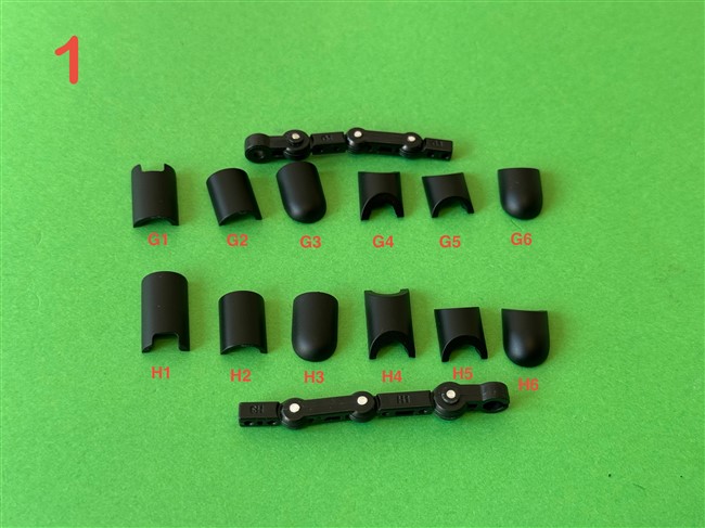

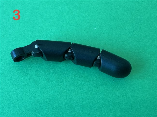

Issue 84
Right Ring and Little Finger
As you did with the previous hand, identify all the ring and little finger segments. Take the structures and place the first top three segment by push fitting the parts in place. Do the same with the bottom segments., picture 2.
