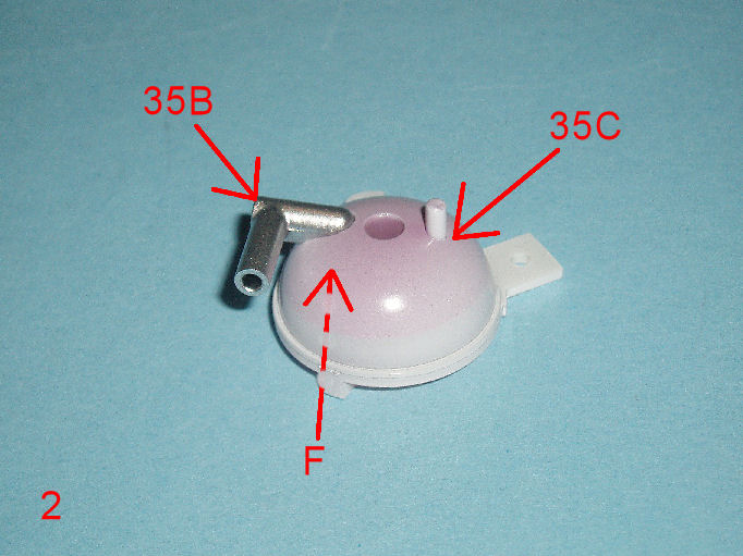

Coolant reservoir.

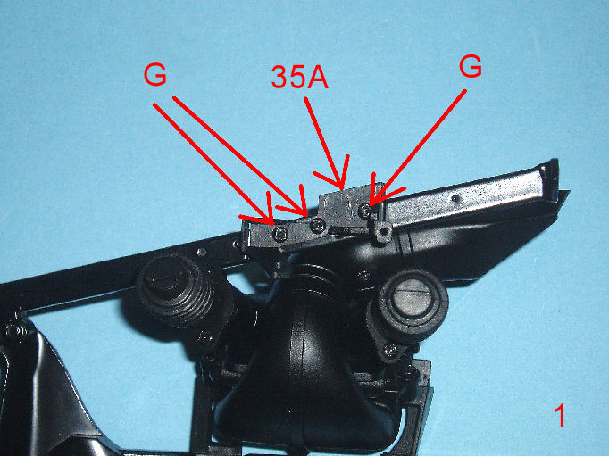

Pic 1: Fix the bracket 35A to the frame as shown with 3 x G screws.
Pic 2: Fit the pipe 35B into the reservoir base 35C and fix with 1 x F screw on the inside.

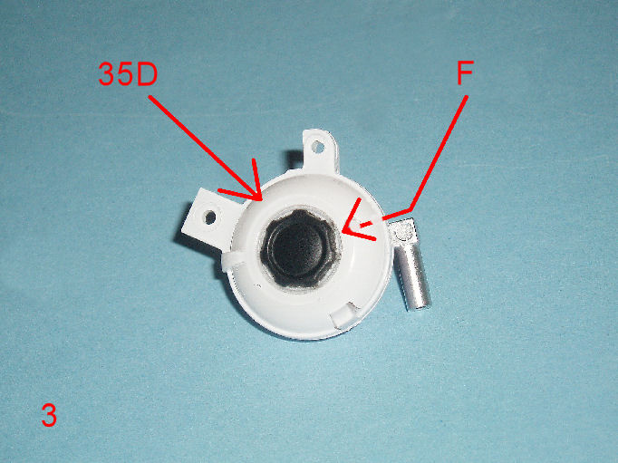

Pic 3: Fit the top 35D and fix from underneath with 1 x F screw.

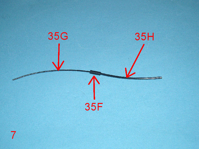

Pic 7: Fit the 3 x pipes 35F, 35G and 35H together as shown.

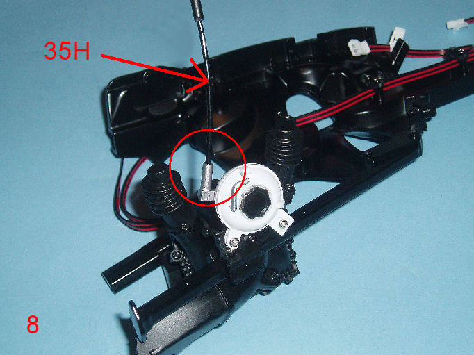

Pic 8: Fit the thicker pipe into the reservoir fitting as indicated.

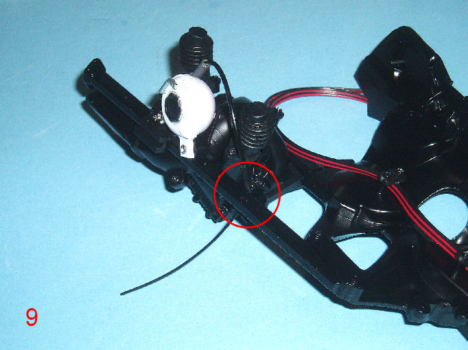

Pic 9: Feed the thinner pipe underneath the upper frame bar.
Store safely for now.
