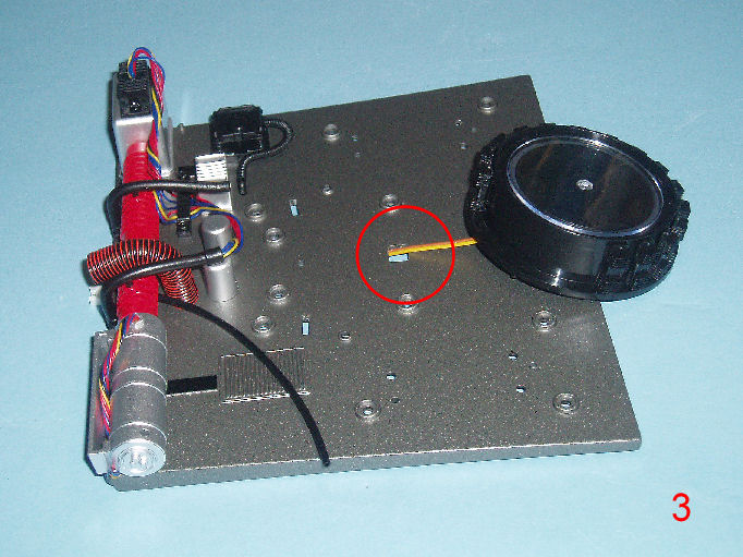

Pic 3: Fit the cable through the reactor base as shown.
Pic 4: Reactor fitted.
Pic 5: Fix from underneath with 2 x BP screws.
Pic 6: Fit the LED wire into the groove under the base and fix the end with the clip 114B and 1 x KM screw.
