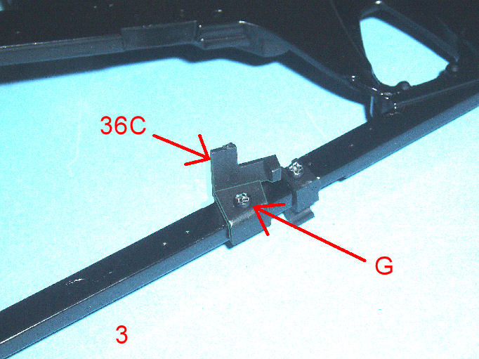

STAGE 36:
Right rear frame.
Pic 1: Fix the bracket 36B to the top of the frame 36A with 1 x G screw as shown.
Pic 2: A different view of the assembly.
Pic 3: Fix the bracket 36C to the top of the frame 36A with 1 x G screw next to 36B as shown.
Pic 4: Store safely for now.
