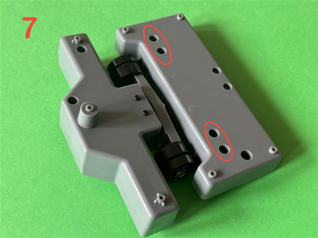

Issue 90
Waist and Abdomen
Slot the friction disc into the seat support and secure in place using 4 x AA screws, picture 2.
Fit the assembly into the lower waist block and secure in place using 2 x Y screws, picture 3.
Fit the mobile left arm of the support onto the assembly as shown in picture 4.
Fit the assembly onto the assembly from issue 88 and secure in place using 4 x Q screws with four washers as shown in pictures 5 and 6.
Next rotate the assembly 90 degrees and fit the lower waist block, securing it in place using 4 x F screws, picture 7.
That completes the assembly for this stage.
