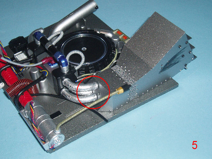

Pic 5: Fit the assembly to the reactor base making sure the 3 x pipes indicated locate in the holes at the rear correctly.
Pic 6: Fix from underneath with 3 x FP screws.
