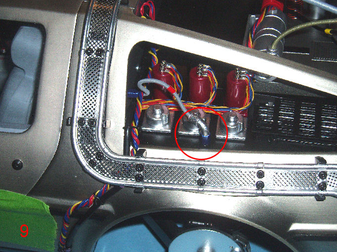

Pic 9: OPTIONAL – You could recolour the screw heads silver to blend them in better with the cowl.

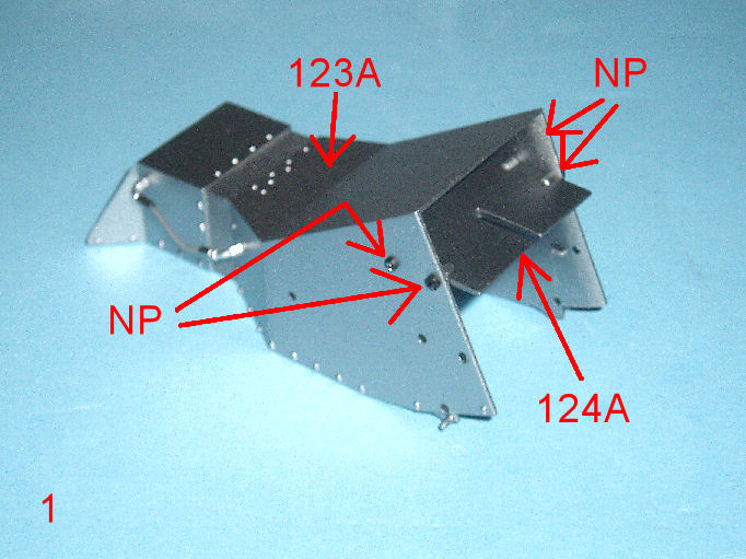

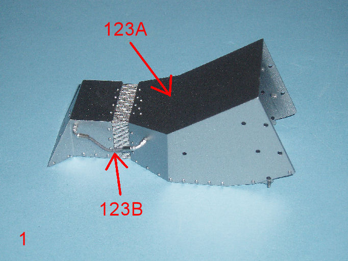

STAGE 123:
Right reactor cowl.
Pic 1: Press-fit the pipe 123B into the locating holes in the side of the cowl 123A as shown.
Store safely for now.

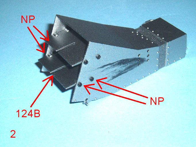

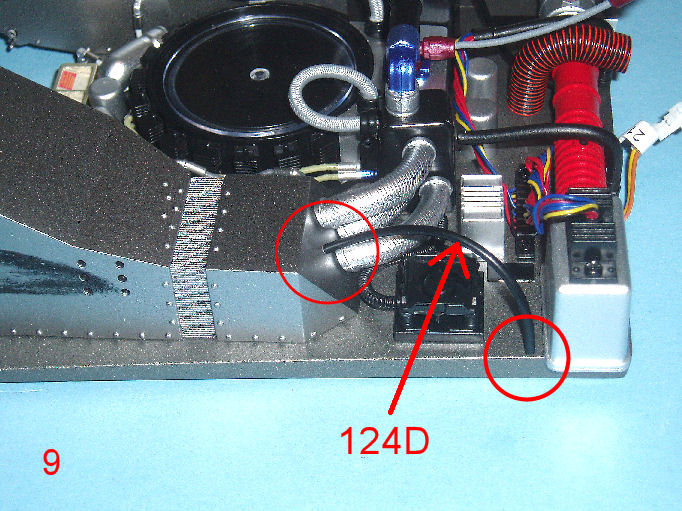

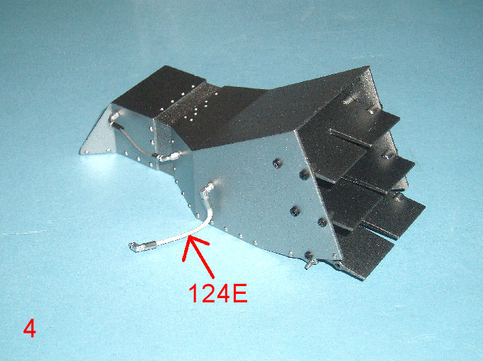

STAGE 124:
Right reactor cowl vanes and fitting.
Pic 1: The 3 x vanes are numbered – 1, 2, 3.
Fit vane 1, 124A as shown and fix with 4 x NP screws.
Pic 2: Fit vane 2, 124B as shown and fix with 4 x NP screws.

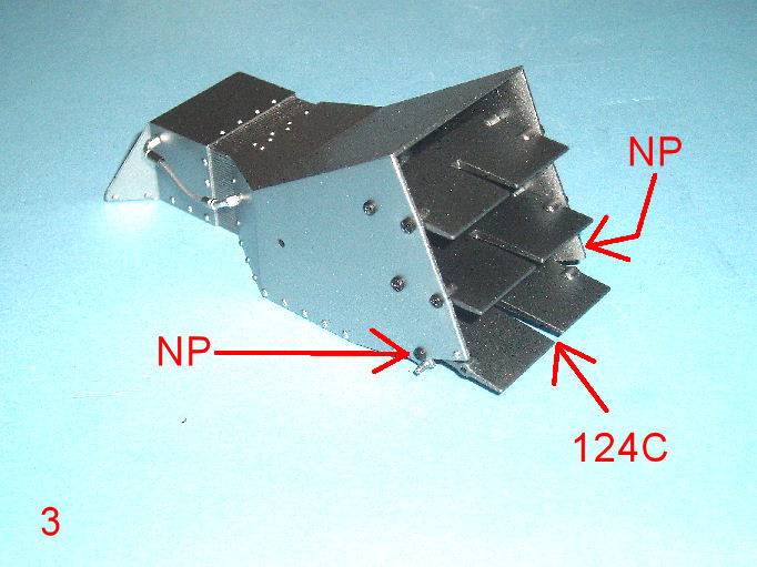

Pic 3: Fit vane 3, 124C as shown and fix with 4 x NP screws.
Pic 4: Fit the pipe 124E where indicated.

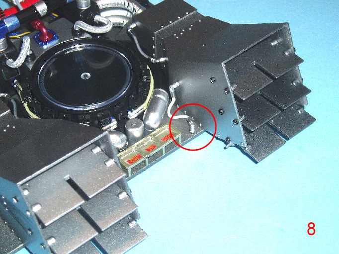

Pic 5: Fit the assembly to the reactor base.
Pic 6: Make sure the 3 x pipes indicated locate in the holes at the rear correctly.

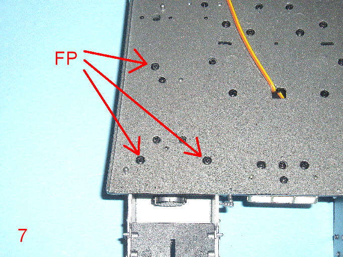

Pic 7: Fix from underneath with 3 x FP screws.
Pic 8: Connect the hose at the front where indicated.
Pic 9: Feed the black tube 124D through the rear of the cowl as shown and fit to the pin on the base where indicated.
OPTIONAL – You could recolour the screw heads on the cowl silver to blend them in better with the cowl body.

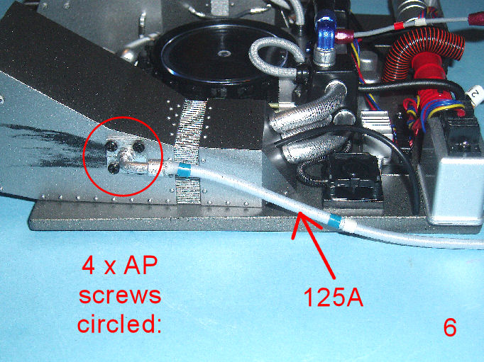

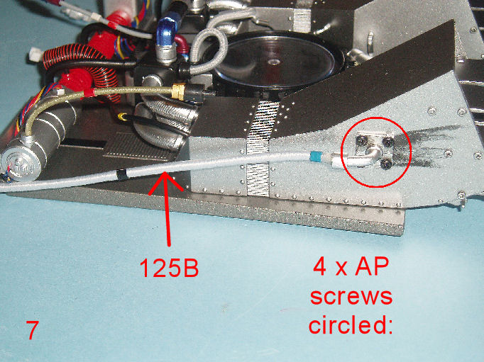

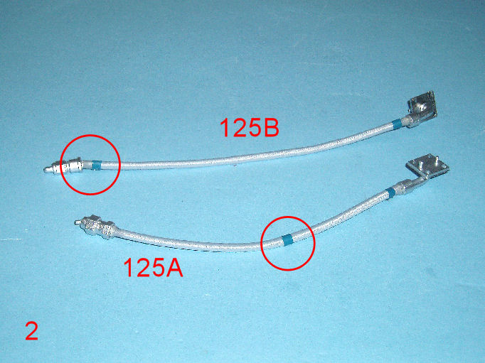

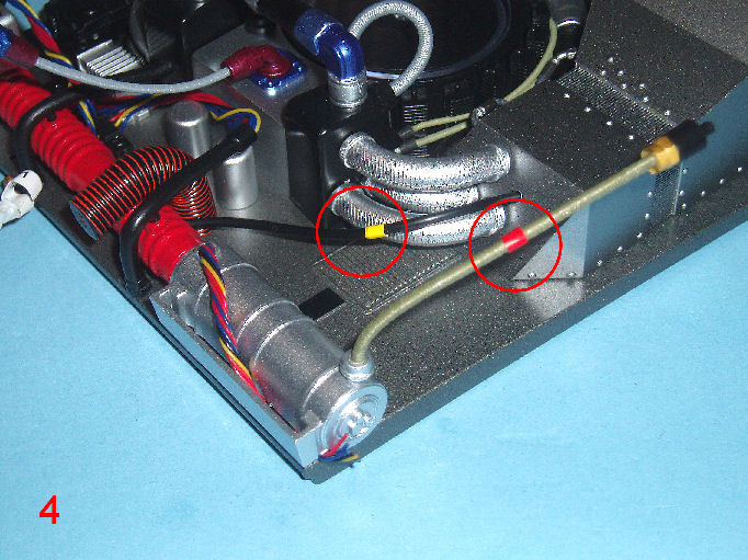

STAGE 125A:
Cables and reactor fitting.
Pic 1: Locate the cables 125A and 125B.
The smaller end on 125A is angled.
Wrap 1 x blue strip from 125C around each cable where shown.
Pic 2: Wrap two more blue strips around the cables where indicated.
Pic 3: Wrap 1 x black and 1 x cream strips as shown.
Pic 4: Retrieve the reactor assembly and add 1 x yellow and 1 x red strips where shown.
Pic 5: Fit 1 x red and 1 x cream strips to the cable as shown.
Pic 6: Fix cable 125A to the cowl shown with 4 x AP screws.
Pic 7: Fix cable 125B to the other cowl with 4 x AP screws.

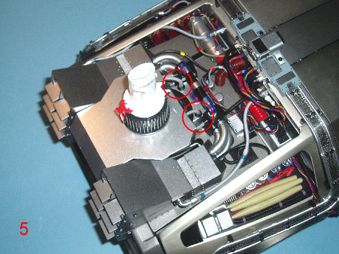

#5 Posted : 18 October 2026 14:14:10
Posts: 5,793
Points: 17,531
STAGE 125B:

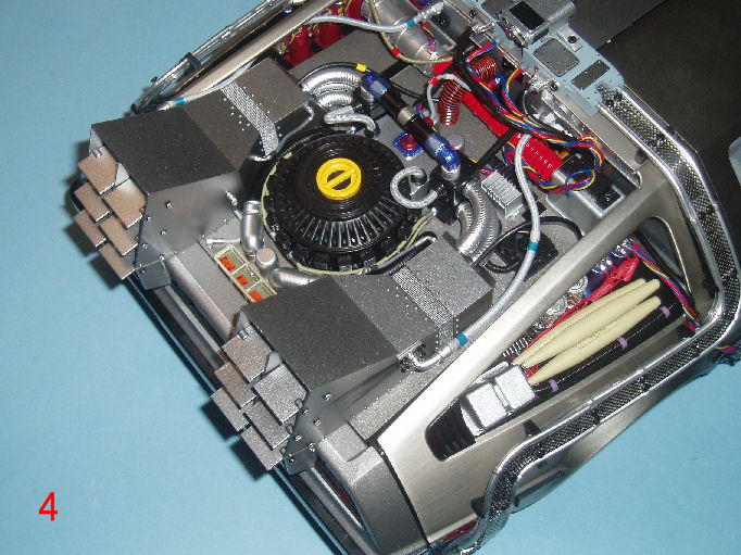

Pic 8: Position the reactor assembly on the rear of the car and connect the wires as indicated.
Pic 9: Feed the wires down inside the car and move the reactor into place.
Connect the cable as indicated.
Pic 10: Reactor assembly in place.
Pic 11: Connect the cable as shown.
Pic 12: Connect cable 125B as shown.

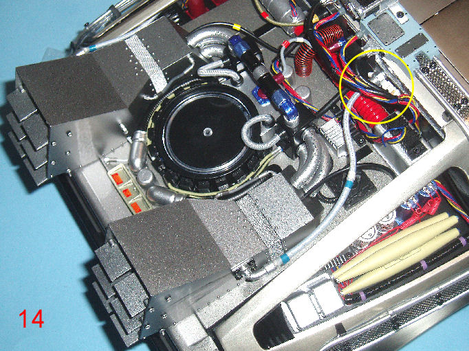

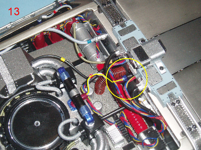

Pic 13: Connect the central cable highlighted in yellow where indicated.
Pic 14: Connect cable 125A as shown.

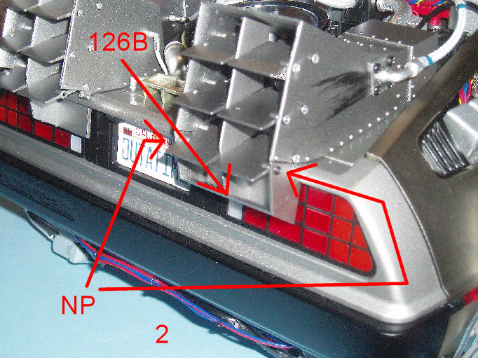

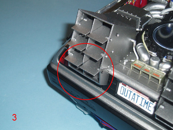

STAGE 126:
Completing the car.

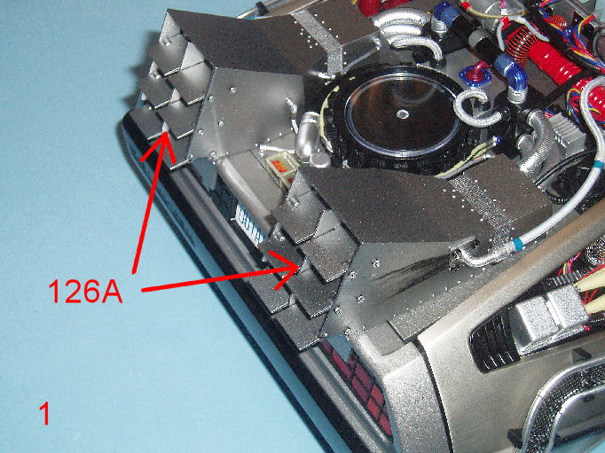

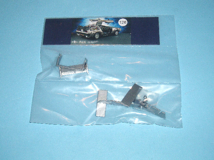

Pic 1: Press-fit the 2 x vertical vanes 126A into place as shown.
They are both the same.
Pic 2: Fit the lower cowl 126B in place as shown and fix with 2 x NP screws.
Pic 3: Repeat on the other side.
Pic 4: You can now fit the original reactor cover.
Pic 5: If you wish to fit the Mr Fusion unit you will need to remove the 2 x cables indicated.
Do not lose them as you may wish to re-fit the original cover at some point.
