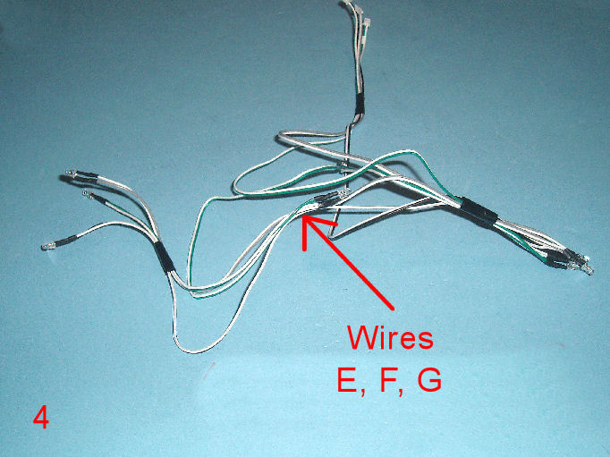

Group the LED’s into threes so there are one of each LED in each group, with two spare G LED’s on their own.
Using some tape temporarily will help keep the LED’s together.

STAGE 94C:
Pic 12: Use pieces of tape 94F to fix the wires down.
Pic 13: Do the same on the other side.
Pic 14: Plug the 2 x unused LED’s into the lights as shown.
