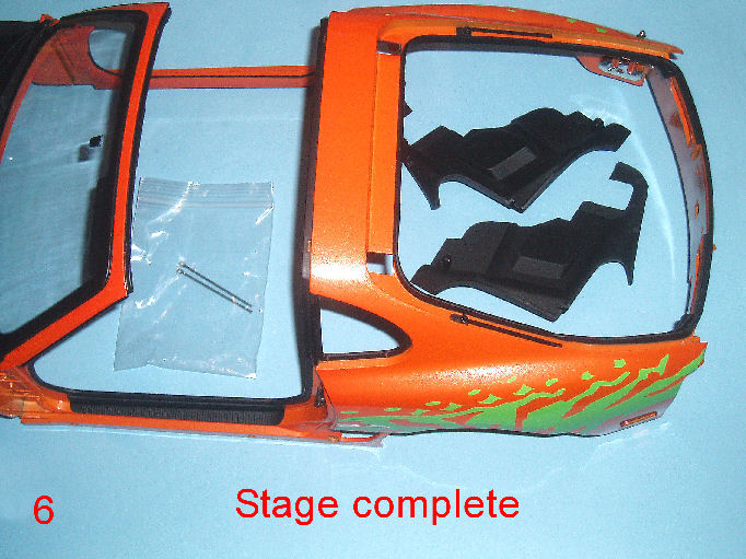

STAGE 95:
Boot panels and cylinders.

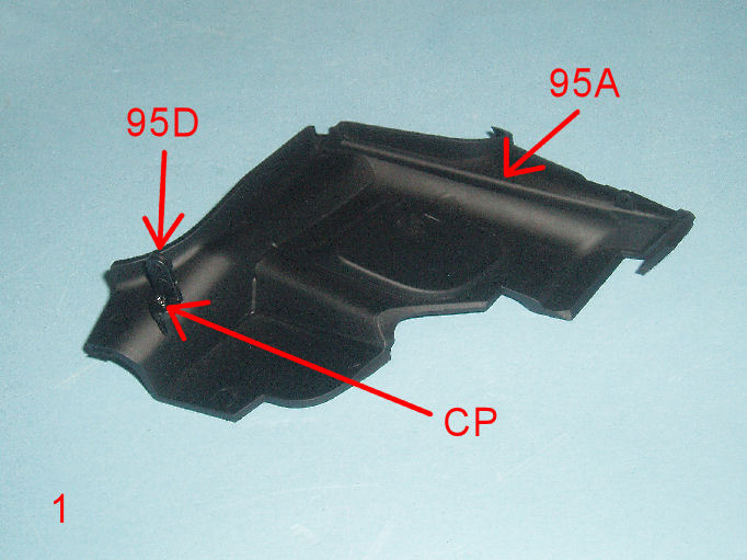

Pic 1: Fix the bracket 95D to the panel 95A with 1 x CP screw.
It will only fit one way.

Pic 6: Store everything safely for now.
