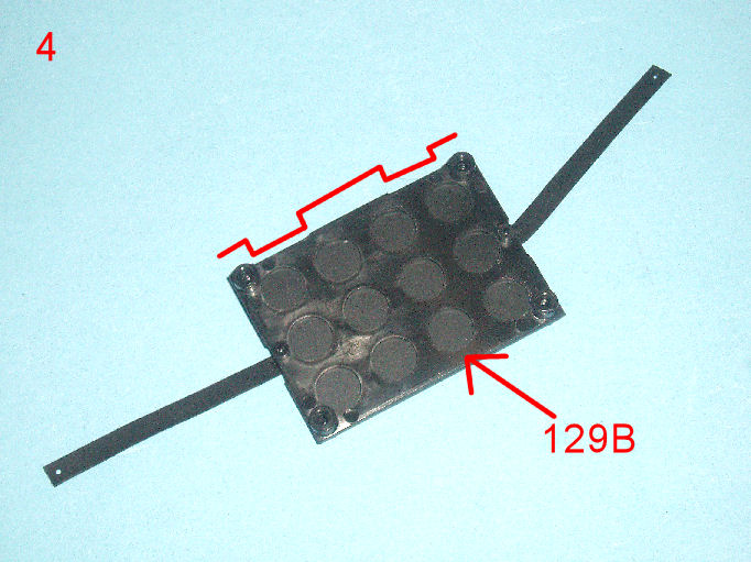

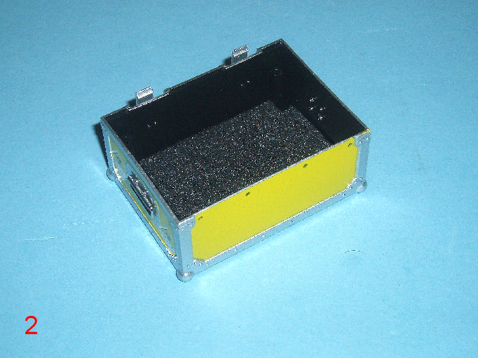

STAGE 129:
Plutonium case.
Pic 1: Locate the interior pad 129D.
Pic 2: Peel the backing paper off the pad and stick it down inside the case bottom.
Pic 3: Fix the 2 x straps 129E to the inner panel 129A with 2 x IP screws.
Pic 4: Turn the assembly over and position the panel 129B as shown with the ridges edges on both panels on the same side.
Pic 5: Fold the straps over and fix each end to the upper panel with 1 x IP screw.
Pic 6: With the screw/strap fixings underneath, fix the flat panel inside the case lid with 4 x AP screws.
Pic 7: Again with the screw/strap fixings underneath, fix the other panel inside the case body as shown with 4 x AP screws.
Pic 8: Close the case and fix the hinge 129C in place as shown with 8 x PP screws.
Store safely for now.
