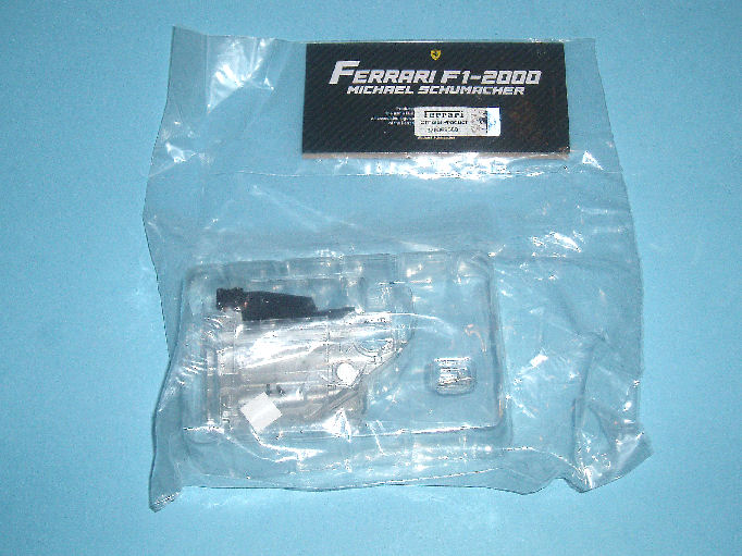

STAGE 33:
Remote control 2.
Pic 1: Retrieve the assembly from stage 32.
The circuit board 33B will fit inside with the silver contacts facing the rubber buttons.
Pic 2: Circuit board installed.
Pic 3: Clip the back cover 33A in place and then fit the battery holder 33C.
The remote control will need 1 x CR2032 battery – not supplied.
Pic 4: Store safely for now.
