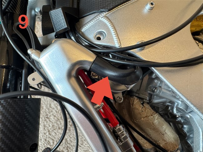

Issue 54 Part 1
Retrieve the radiator assembly from the last issue and the lower radiator part into the assembly, picture 2. Now fit the radiator guard using 4 x KP screws as shown in picture 3. Take the long pipe and attach it to the bottom of the lower radiator, picture 4.
Now fix the two radiator assemblies together using a UP screw as illustrated in picture 5.
Retrieve the main bike assembly and attach the shorter black tube and connect it to the pin on the coolant pump, picture 6.
Add the radiator assembly to the frame and attach the first of the AM screws, picture 7. Turn the assembly over and attach the second AM screw, picture 8.
Attach the short pipe on the left side of the model to the upper connector on the radiator side panel, picture 9.
That completes the assembly for Part 1 of this issue.

Issue 54 Part 2
On the right side, attach the lower radiator to the anchor, which is already installed using a UP screw, picture 10. Now the radiator is connected, connect the pipe to the upper connector, picture 11.
Attach the long pipe to the connector on the radiator side panel, picture 12. Turn the model over and connect the cable to the oil pump pin, picture 13. Connect the two cables to the front braking system’s connectors as illustrated in picture 14.
Turn the assembly so the bottom of the frame is showing and connect the end of the long pipe to the pin on the oil filter, picture 15.
Picture 16 shows the assembly complete for this issue.
