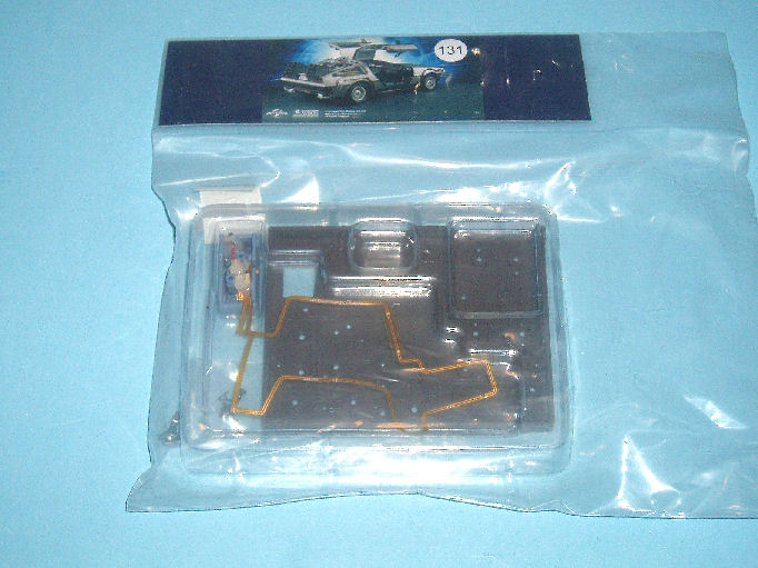

STAGE 131:
Emergency time circuit.
Pic 1: Press-fit the support 131C into the time circuit box 131A as shown.
Pic 2: Fit the LED strip and battery box into the casing, fixing the battery box from underneath with 2 x AP screws.
Fit the LED strip into the locating track and fix with strip of tape 131D.
Take care not to put tape over any of the small LED’s.
Pic 3: Optional detail – you can add decals to improve the look of the wooden box.
The decals can be found online.
Store safely for now.
