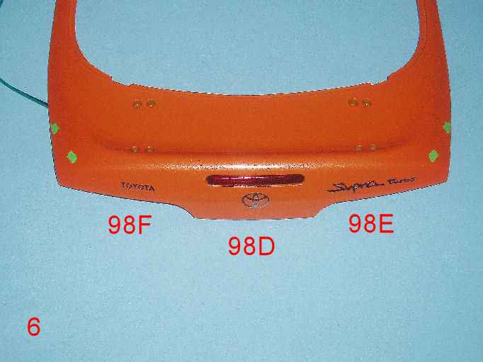

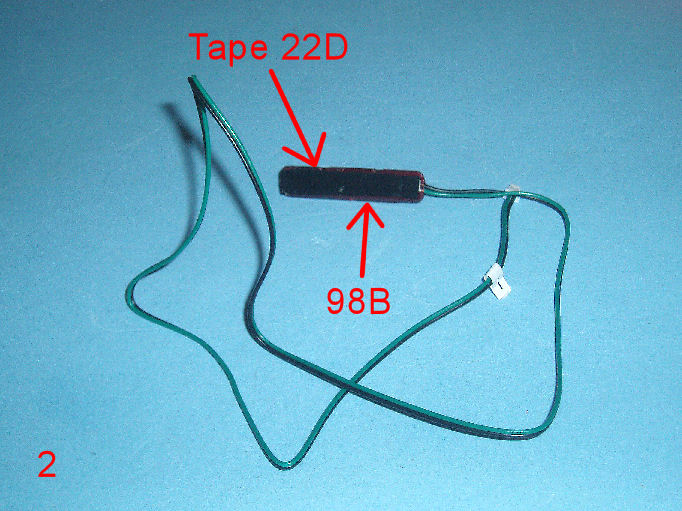

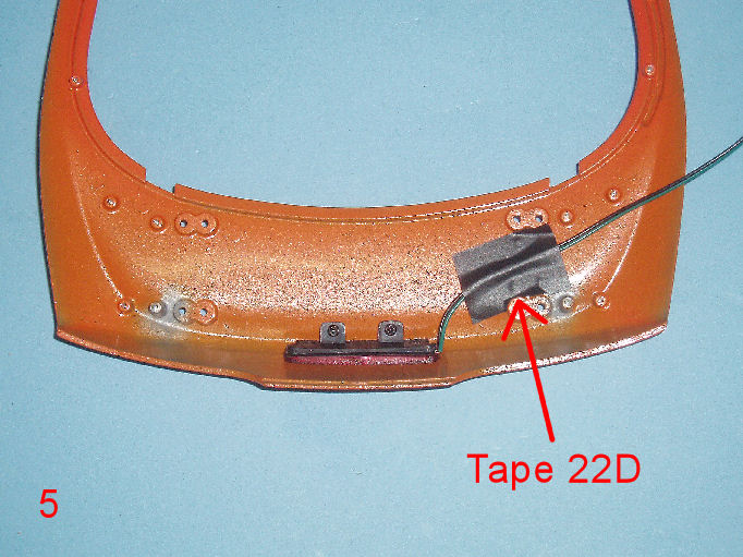

STAGE 98:
Tailgate and brake light.
Pic 1: Retrieve the LED wire ‘I’ from stage 44.
Pic 2: Fit the LED into the light housing 98B as shown and secure with a piece of tape 22D.
Pic 3: Fit the light into the tailgate 98A as shown with the wire on the right.
Pic 4: Fix the retaining bracket 98C in place with 2 x IM screws.
Pic 5: Fix the wire down where shown with a piece of tape 22D.
Pic 6: Soak the decals 98D, 98E and 98F in warm water for a few seconds and slide them into place where shown from the backing paper.
Take care to apply them straight as they will stick down very quickly.
Dry with a piece of paper towel.
Store safely for now.
