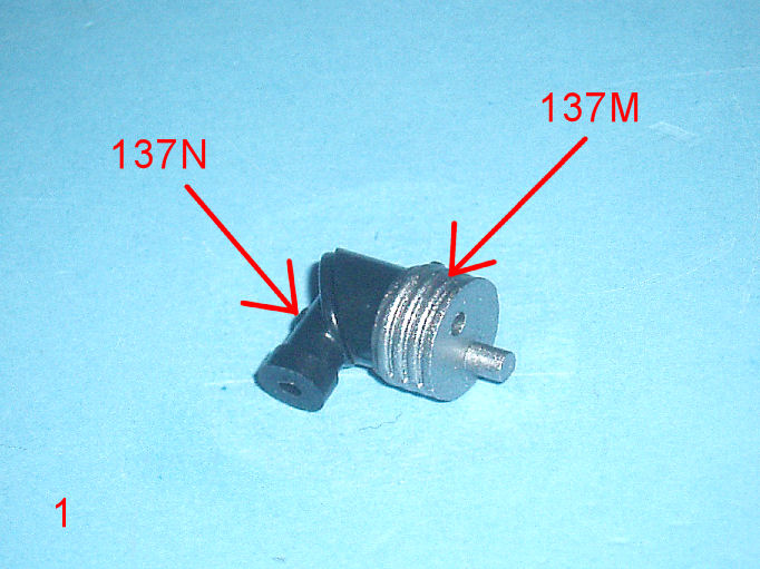

Pic 1: Press-fit parts 137N and 137M together.

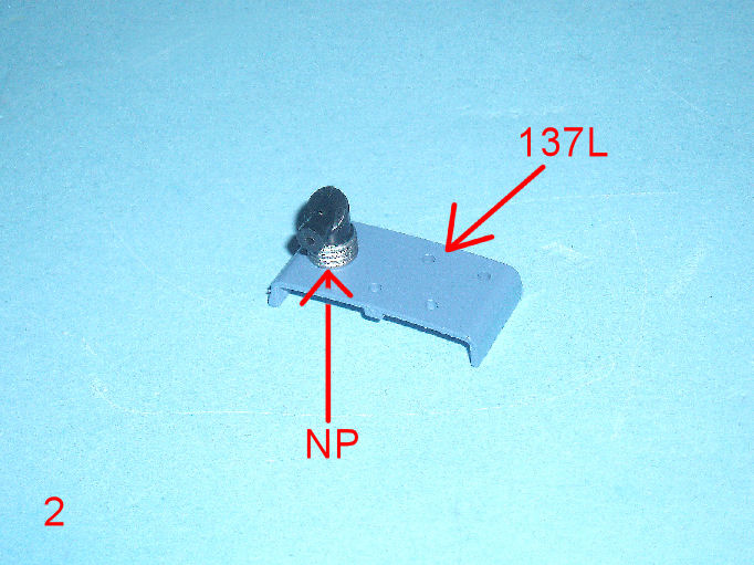

Pic 2: Fit the assembly to part 137L and fix from underneath with 1 x NP screw.

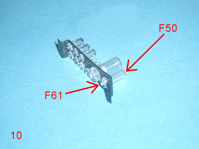

Pic 10: Fit part F61 through the smaller hole and then add F50 over the top on the other side.

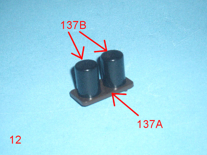

Pic 12: Press-fit parts 2 x 137B and 137A together as shown.

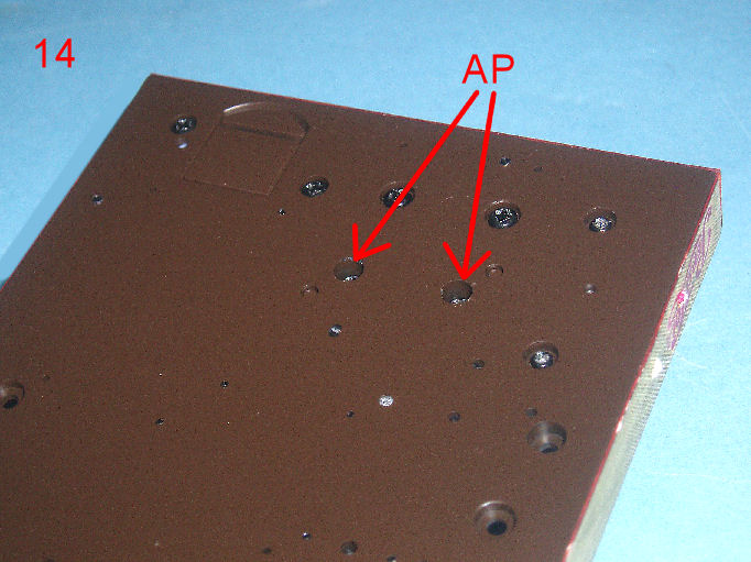

Pic 14: Fix from underneath with 2 x AP screws.
