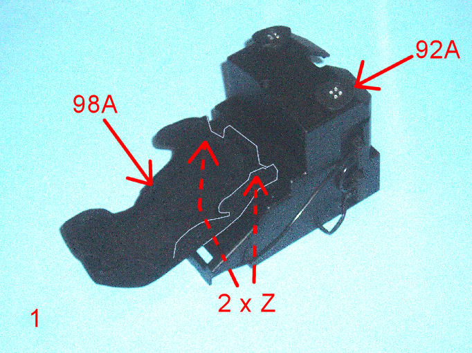

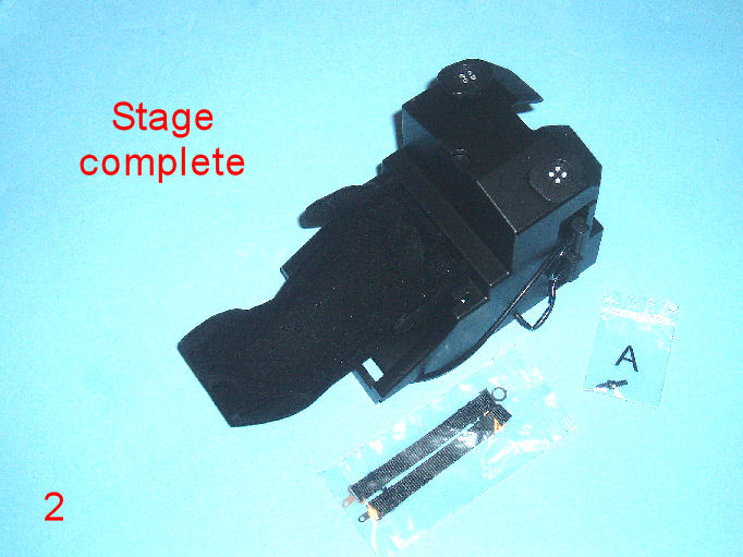

STAGE 98:
Driver’s seat.
Pic 1: Retrieve the fuel tank 92A and fit the seat 98A in place as shown.
Fix from underneath with 2 x Z screws.
Pic 2: Store everything safely for now.
