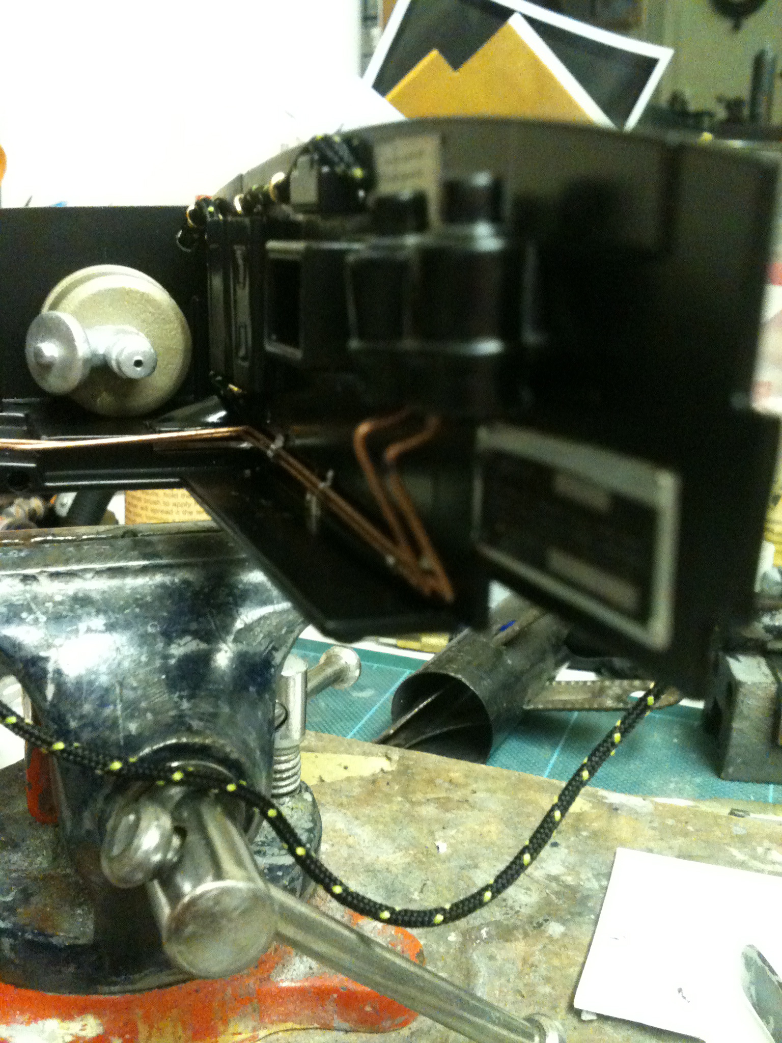

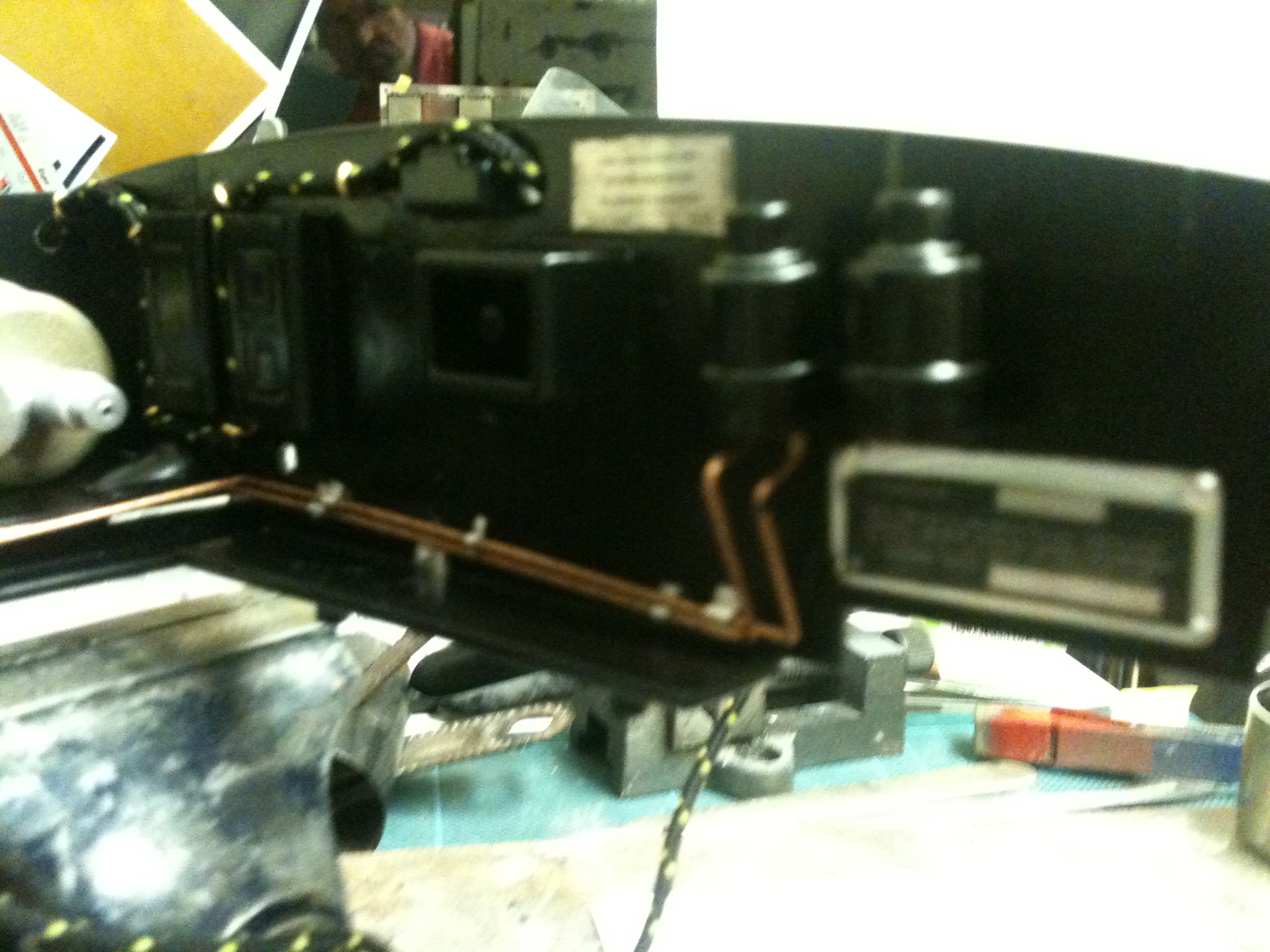

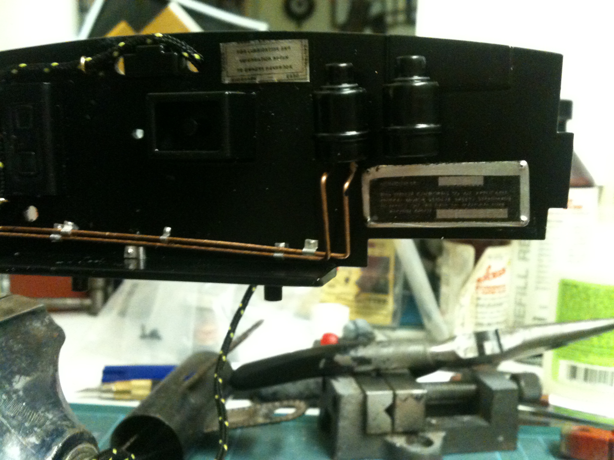

I have to agree with your remarks Senna. For myself because the parts are rather slow I have started to build the 007 DB5 Aston Martin, this model leaves masses of room for modification from interior painting or carpeting the floor to detailing the engine bay prior to fitting the engine (not built yet) all of which fills my time whilst waiting for the Mclaren. I will post a few pics just to show what Im doing.
One tip I do have to pass on for those who may want to use copper wire for brake lines etc. To straighten your wire my tip is to put one end of the wire in your vice, the other into your mini drill, hold it taught and spin the drill for a couple of seconds. It will make the wire arrow straight and also lightly work harden it so when you bend it, it stays put. Also it will give the wire a very slightly ribbed surface for reality.

Thanks for your kind comment, very much appreciated. Excellent stuff there with a fantastic tip for straightening the copper wire and the pipes look very good indeed !! I can see Mike (MWG) having to constantly look over his shoulder at you as your build is looking very cool indeed. Nice to have a third DB5 diary on here to look at and I have to say this is exactly what I was getting at when I started this topic, the need for some interesting stuff to talk about, so I am glad that I brought it up if this is how people are going to respond. Thankyou !!
Well done Tony and keep the pics coming they are very welcome !!! Love ThumpUp
