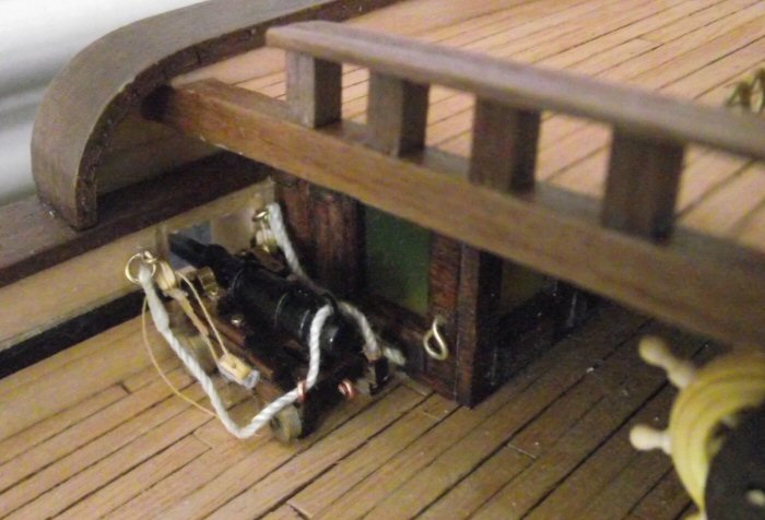

Nice work! Good to see another enhancement of another key area. A little info mate the magazine has the cabin fitted a bit to fair forward when you cut the gun ports on the quarter deck the side of the 3rd gun port from the timberheads is right next to the cabin and the cannon blocks the door.
Son of Bulwark attached the following image(s):

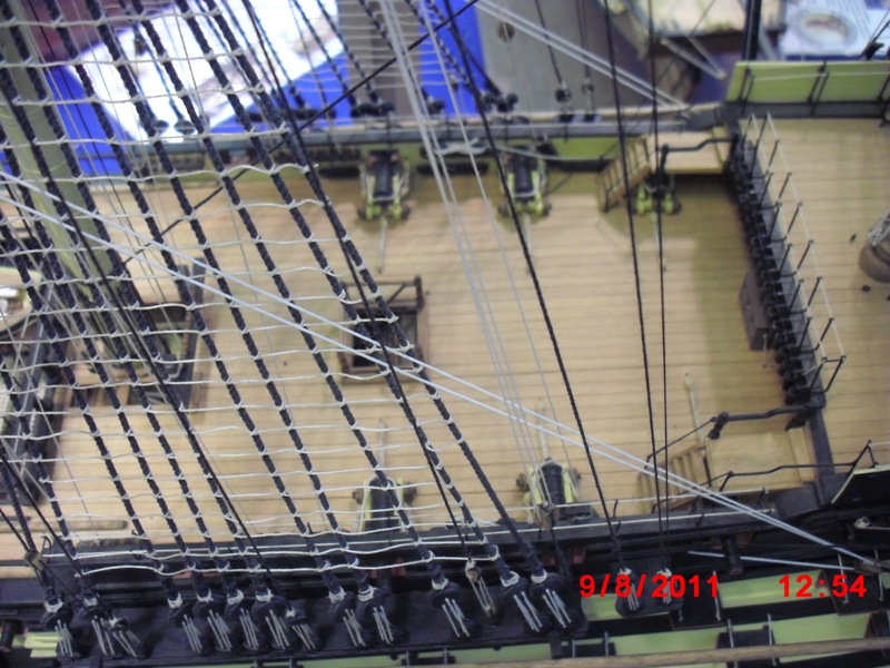

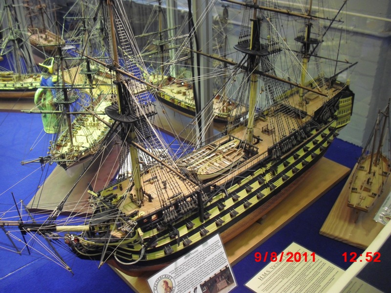

Hi Jase I love what you are doing with this enhancment, is this any help, notice the walkways over the Guns to the steps:-
CALDERCRAFT PRODUCTS 002.jpg (263kb) downloaded 49 time(s).
