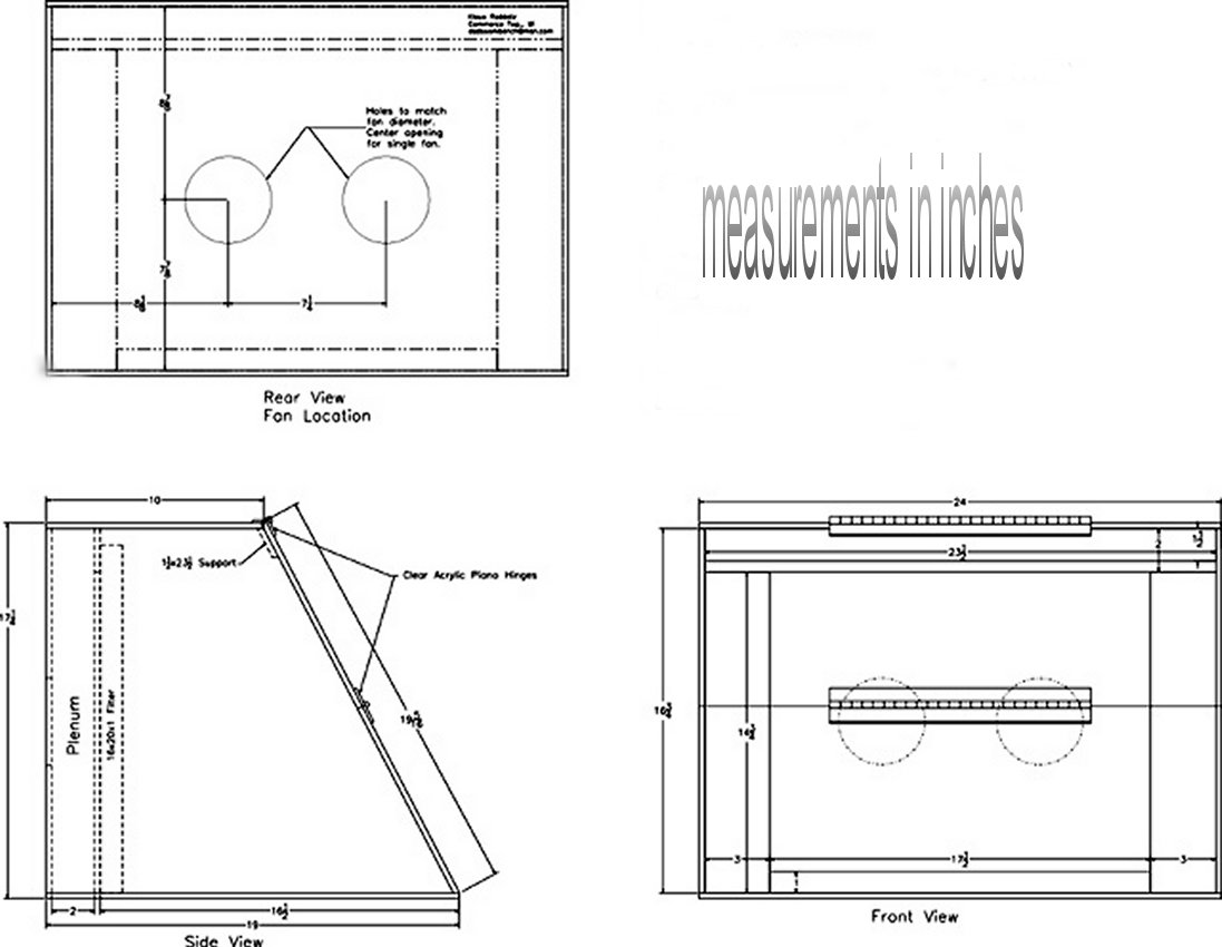

You can make a spray booth from a good size cardboard box with some kind of extraction filter/vent on the back so it can be cheap or you can go down the expensive road of buying a custom one...or Find an old oven hob extractor with filter compartment and make a simple box from wood.. get a lazy susan ( no offence to anyone who has a partner/wife of the same name BigGrin )for the turn table so you can get acces from all sides..
plonk the extractor on top and you have a good booth..
Google "scale modeling spray booth plans" and you will have enough to choose from..
Or if your really brave and don't mind losing your undercarriage than try this SPRAY BOOTH FOR REAL MEN

I was thinking of using some plywood, making the box, for the fans I was thinking of using 2 maybe 3 CPU fans from a computer (cheap and pretty powerful) and then a filter from a air conditioning unit.

The fans you will need are maybe 5" case fans and if you have an old PSU from a desktop comp then that will power them.. just a cheapo one from pcworld but with an on/off switch on the back..
As mentioned above just google "spray booth plans" to give you an idea Dan

My feelings now are plywood box, one extractor fan as you would find in a bathroom, under cabinet strip light and a filter screen with a dryer hose out the window.
Now, time to plan and measure up!
