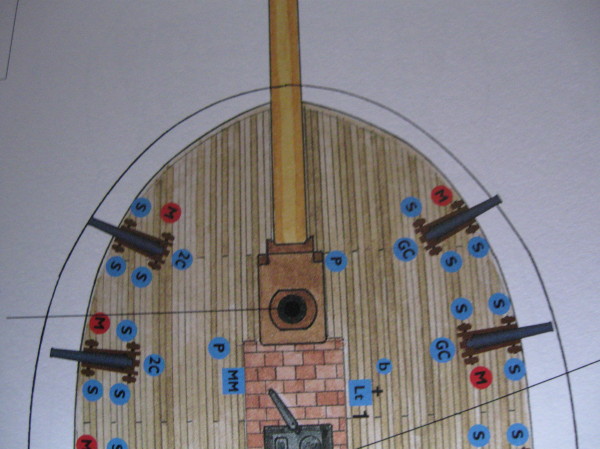

Hi All,
On the following i need some feedback on what to do.. tried to depict it as good as possible:
According the book i bought, it seems that the gunport at the lower deck & at the curvature of the bow needs to be cut like the blue lines, but is this correct for our build?
Or should i cut out along the orange lines, altough then the lid covering the port would be way bigger. Unless i use the green line for the right cut-out out of the outer planking?
Anybody any ideas? Im about to start milling the planks..
Thanks a lot,
Vik
#2 Posted : 20 May 2012 10:11:00
The cannon should be placed square to the port as per the photo below
