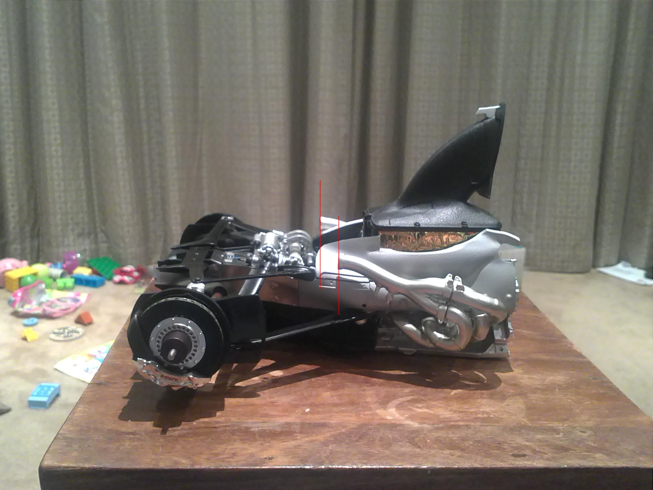

Hey guys,
just completed the exhaust installation and noticed that they don't line up fully and look a little wonky?Confused
Now it doesn't say any where that they should be wonky, and I can't really tell from the pictures if the official build is the same
Has anybody else found this?
I can't see how they could've gone together any other way so can't understand why they don't line up with each other?
Copy of IMG312.jpg (382kb) downloaded 254 time(s).

If 'wonky' means offset in length, then you have them correctly fitted.
The outlet length of both manifolds purposely differs for the reason stated below, which relates to the design of the real engine.
On all V-engine blocks, the cylinders on one side cannot be perfectly parallel to cylinders on the opposite side.
On MP4-23, the cylinders on left-hand side are offset towards the rear, this means that the exhaust outlet of the left side (looking from the rear) appears slightly longer towards the rear than that of the right-hand side.
In real life the length of the exhaust pipework needs to be the same length on each side to obtain optimum performance, and since the exhaust outlets of the left cylinders are offset towards the rear, it means that the left manifold naturally looks slightly longer than the right-hand manifold when mounted on the engine (when viewed from the rear), which is how it should look and is also reflected in the issue 1 poster.

The only thing you left out is the reason the cylinders can't be parallel.
Pretty obvious though if you think about it - it's because the piston con rods all go to one crankshaft, so the con rod on a 'left hand' piston, has to fit between the con rods of two 'right hand' pistons, and vice-versa, and so-on.
Staggered pistons/con rods = staggered cylinder heads = staggered exhausts.
I'm glad this was raised though, as most of us would also possibly have thought there was a problem with our build.
Roy.

Well explained!
Many thanks, just wanted to make sure I'd done it correctlyBigGrin
