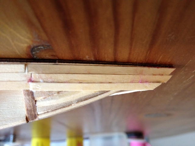

In this case the J class in the bow does not really need too much bending. I am using the glue and then tying a thread tightly for a few minutes to hold the planks in place. Saves me labour of hammering in nails which split the planks or leave a visible hole.
My biggest concern is the point where the two tapered planks meet at the bow. I am not getting a straight sharp line. Hoping using sand paper in the end will help me smoothen out these jagged tapers.
lohitsa attached the following image(s):
