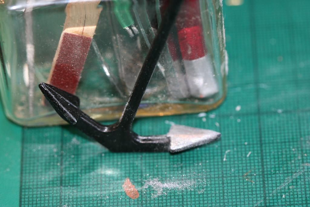

having started the mk11 victory,and the anchor come early in the build I thought this little tutorial would be helpful to the new builders coming on line.
this first pic clearly shows the mould lines along the shaft and on the blades,so the first part of this assembly is to remove them with a small file.
the next job is to paint on the metal primer.
whilst that is drying I made a start on the wooden shaft by filing slots in the centre of both pieces.
I then sanded and glued together the 2 halves.
next job was to bind the wood,I used copper tape,drill and brass pinned the stock and started to make the anchor ring.the one supplied is to small,scale wise.I wrapped 1mm. brass wire and wrapped it round my craft knife(16mm.dia.)then cut in the centre of the cross over.
next,binding of the ring which is call the "Puddening" you use any thread ,when finished paint it black.
that's it folks,good luck and enjoy,this is my take on this subject,feel free to do your own thing,and please comment if you think this was useful. karl...........BigGrin

Many thanks for a very informative tutorial.
Like your use of the copper tape rather than the thread bindings in the magazine build.
