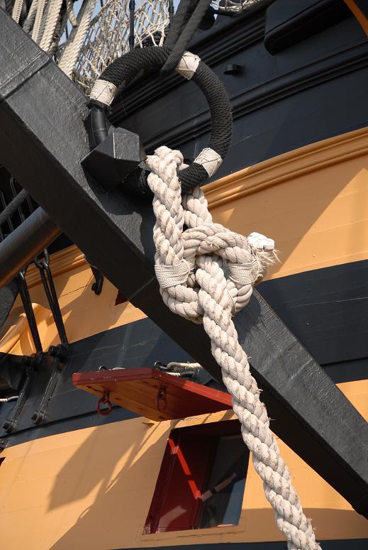

Done the same Jamie, not sure if its out of scale until it is time to attach to the build and after seeing the real thing last Friday and the ropes are enormous.

Hi andylangtree! BigGrin
Look to be about right! the rope used is slighty smaller that the width of the anchors shank as you can see from the picture.
Hope this helps! Cool

Don't look at the picture Richard...hairy rope alert!!!LOL

No!!!!! Not hairy ropes Glare Glare
The anchor cable needs to be large for a ship like Victory. It isn't the anchor which keeps a ship moored in one place, it is actually the weight of the cable as well as the anchor holding one end of the cable to the sea bed. Therefore the larger the ship, the larger the cable.

I believe I am right in saying that you need 1.5x depth of cable run out,it then sags in a loop& runs along seabed to anchor.Once anchor dropped ship is taken "aback" so that the correct length is out.Thats what I seem to remember from my Sea Scout days anyway..no doubt someone will correct me if i'm wrong.

Sounds about right! All my knowledge is from books, trouble with living in Leeds is that there is not a lot of sea to practice on! Taken aback means that the ship is essentially facing the wrong way and the wind pushes the sails back against the masts. Therefore when anchoring, the anchor is dropped and the ship allowed to drift back paying out the cable until there is sufficient scope to keep the ship steady. The cable is then secured to the 'riding bitts' which are significantly large timbers on the deck of a sailing ship just forward of the foremast.

The thread you've used certainly looks accurate, nice job.
