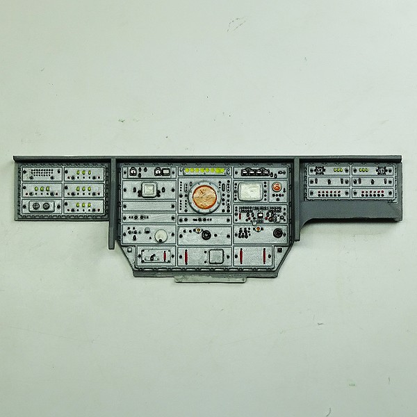

The initial part of the build is preparing the internal hull cabin. Both sides of the missile controllers positions are extensively moulded and from photos appear to be fairly accurate in their representation. Trumpeter supply individual decals for each panel which you could either attempt to lay over the raised detail (very hit & miss) or remove the raised detail and apply the decals to a flat surface. I decided to hand paint the raised detail for, hopefully a better end result.
richmal attached the following image(s):

Completed the second of the main cabin panels using a few decals that have dial representations too small for me to paint.

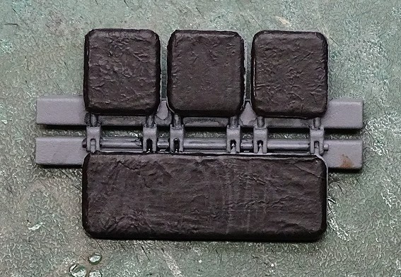

Continuing with the interior cabin detailing i now move on to the crew seats. As in most cases in standard plastic models the crew seats are re fairly basic with little or no showing of wear or use. To overcome this I tend to cover the padded part of the seats with kitchen foil. Initially screwing it up and then gently teasing it out to get a sort of texture. This is then superglued over the kit part and folded down the sides of the seat. Any overlap is removed with a sharp craft knife. The result is then undercoated and then given a coat of the required seat colour. This now gives you a rougher surface which can be drybrushed to bring out the detail.

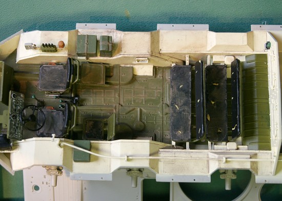

Results of the interior. The panel at the rear was taken from the only reference photo I could find of the rear interior of the cabin. Cropped the image to the required size, printed and glued in place using No More Nails glue.
Whoops, forgot photos.
richmal

I picked up the tip from a build on a BTR60PB, and tried it for the first time on my own kit. The foil can be cut and folded to show rips on the seating.

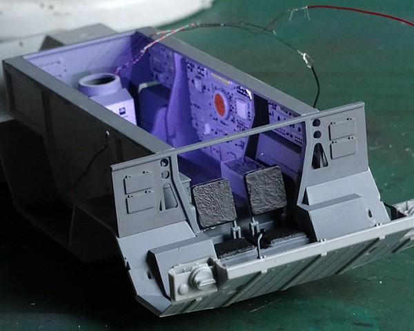

Time to see if my idea of lighting is going to work. LEDs of 'pico' size with a switch and coin battery are supplied by a US Model Train shop. The battery and switch will be housed in the base of the radar/missile array unit.
With house lights turned off in a fairly dark room this is the result.

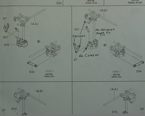

Moving on to the suspension. The instructions do not tell you that the front and rear wheels are steerable, albeit individually. I discovered this after cementing part D7 to parts D15 on my first sub assembly. Sub assemblies (A-A) & (B-B) snap fit onto D15 and E10 respectively. The centre wheels are fixed so sub assemblies (E-E) and (F-F) can be cemented throughout but you need to ensure that the wheel hub is at right angles (90 degrees) to the suspension. The first photo shows where not to cement, the second is the suspension units ready to be undercoated. I plan to spray the wheel arches and suspension units with Base Russian Green before moving on. In that way I'm not going to have to fiddle around big wheels to get it all coated with paint..
