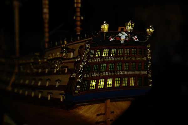

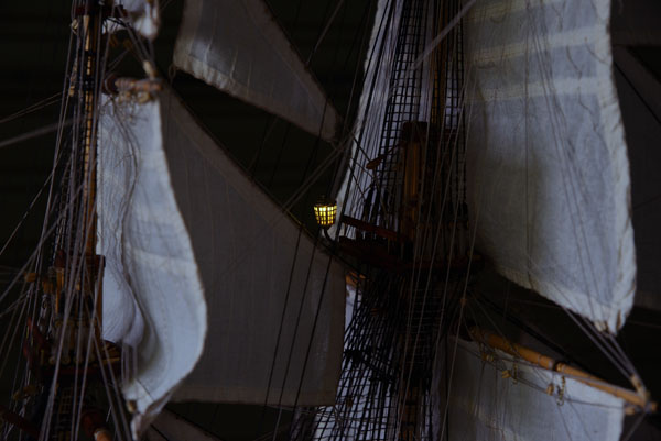

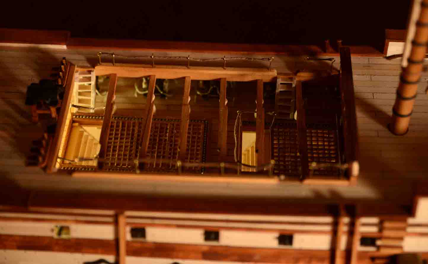

Below are some images of my Victory in progress showing my attempt at Ambient light (Between decks) and Direct light (Lanterns)
Garth attached the following image(s):

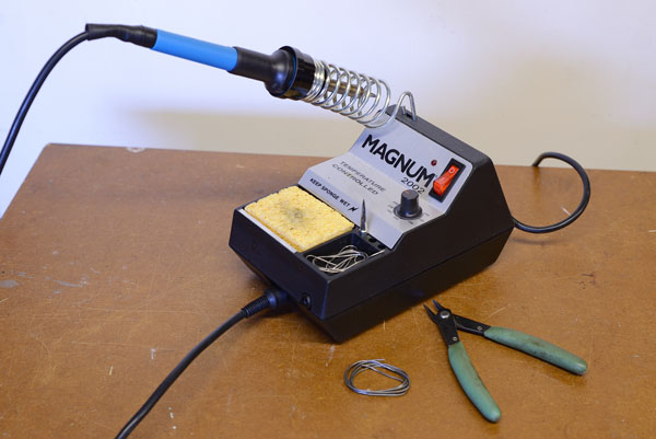

Over and above the basic modelling tools, you will require a soldering iron, flux core solder and a pair of side cutters. A small soldering iron with a pointed tip is best.
An inexpensive soldering iron will more than suffice to complete the lighting. The tools will be available from most large hardware stores and even from the electronics shop.

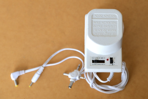

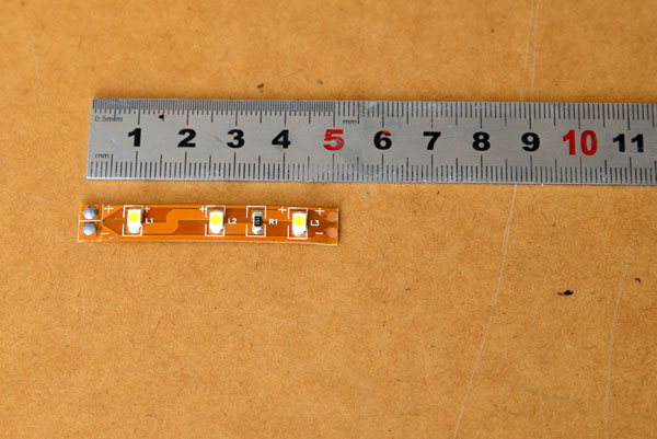

Power supply – 12V DC transformer. Mine looks like a plug and the voltage can be adjusted from 3V-12V. It’s an off-the-shelf item.
LED strips – The type used for under counter lighting. The LED strips are great because they can be daisy-chained together and connected directly to the 12V power supply. I must have used about 6-10 strips.

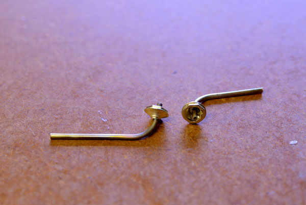

Surface Mounted LED’s and resistor (x4, 1 in each lantern) The surface mounted LED’s will require a resistor. They will have to be bought from a shop the sells electronic components. They will suggest the correct resistor value in relation to the power supply.
Wire. Try to purchase red and black wire. Seen as it is the industry standard for + and -. About Ø1.5mm to Ø2mm wire for the basic wiring and I used very thin wire for the lanterns, around Ø0.7mm. (Two strands must fit the brass tube)If this is not available, then I think that armature wire will suffice. I intend using this in my Pearls lanterns as I have run out of the Ø0.7mm. This should also be available from the electronics shop.

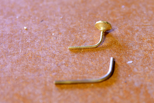

Ø2mm Brass Tube. To replace the lantern mountings.

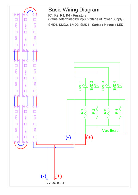

My Circuit
I drilled a small hole in the keel for the wires. I intend to hide this in the stand. The power supply will be below the stand. I’m still not completely sure how I’m going to do this. (that is the reason for leaving that topic until the end of the article)
Once in, I split the wires, one direction going to the LED strips and the other to the SMD PC board.
Connecting the LED strips is fairly easy. Solder the Red wires to the (+) and Black wires to the (-). If you accidentally swap the polarity, the LED will fail to light up – simply reverse the wires and it should work.
The PC board is a little more complicated, but I will upload some pics when I deal with the lanterns. That should make it easier to understand.
I have included a basic schematic diagram of my lighting system (hopefully it explains what I have attempted to convey in the text)
Soldering
Tinning. If you battle to make a proper solder joint, try the tinning method. Essentially a small amount of solder is applied, individually, to the two items to be joined together. This is called ‘tinning’. The two items are then held in contact with each other and a small amount of heat is introduced, by the tip of the soldering iron. When the heat melts the solder, remove the tip and the parts will be joined. Not all components require tinning. Do some tests off the job.
Tips
Keep the tip of the soldering iron clean and free of excess solder. Periodically wipe it off on the sponge, or a damp cloth.
Ensure that the soldering iron has reached operating temperature. Touch a piece of solder to the tip – it should melt instantly.
Do NOT inhale the vapours that are generated by the soldering process.
Practice on surplus components until you are happy with your technique.
Periodically test your circuit to ensure that everything works. If one LED or LED strip does not light up – check the polarity and then the solder joints.

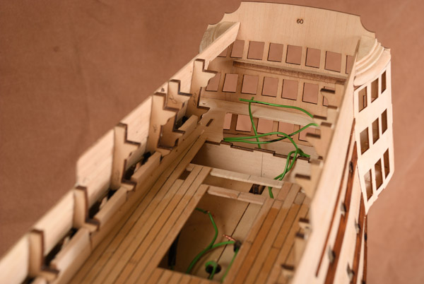

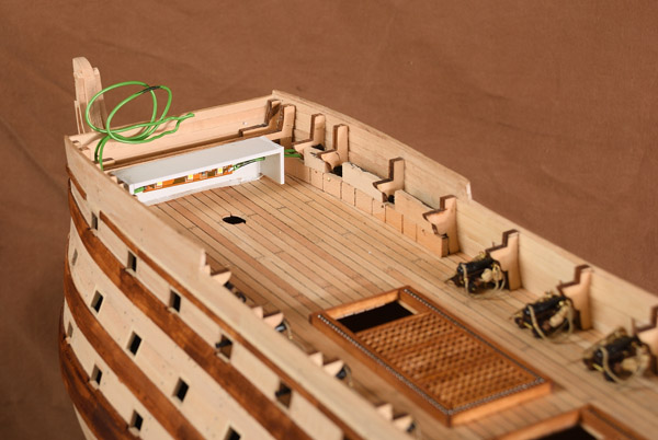

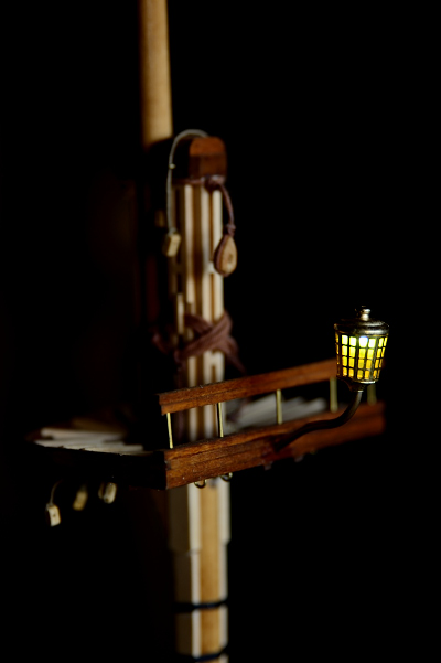

4. Ambient Lighting

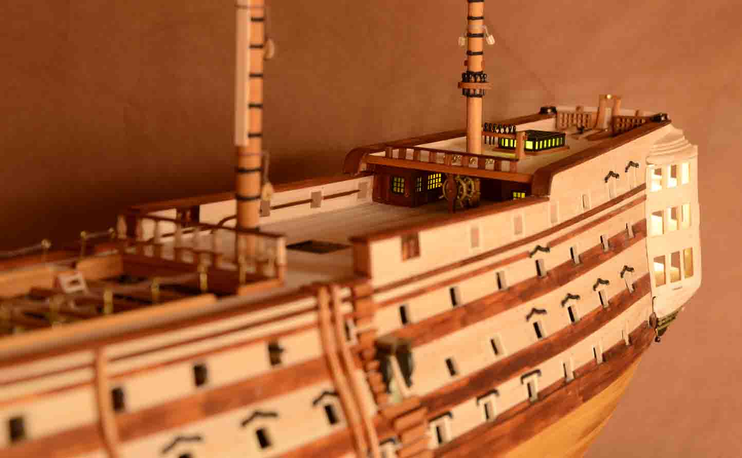

My intention here is to have a soft light that will visible through all the openings, i.e. gun ports, doorways, gratings and openings in the desks. The second part is to provide a glow through the Stern gallery and the Officers’ cabin windows. To accomplish this, I used the LED strips.
I fitted the LED strips on the bow and stern ribs facing inwards towards each other between the Lower and Upper Gun decks. I positioned a couple in the stern to illuminate the gallery. Unfortunately, I do not recall the exact positioning – I basically made it up as I went along.
I made a basic light box out of styrene to prevent the light bleeding through the decks.
Please note, I only had green wire when I started this, but I did mark the ends of the Negative wires with a black marking pen. Not ideal, I would suggest rather using red and black wires.
No rocket science here, this part was pretty easy.

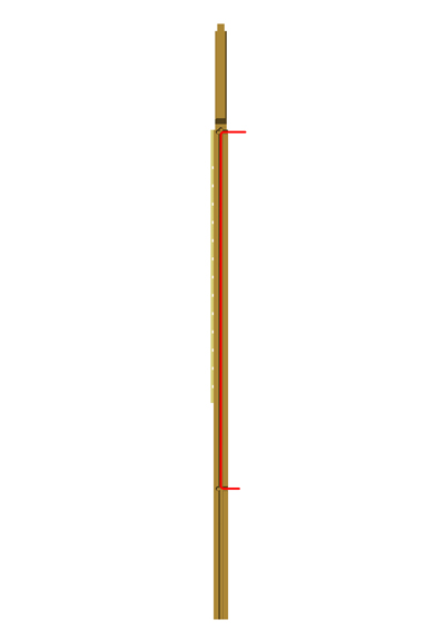

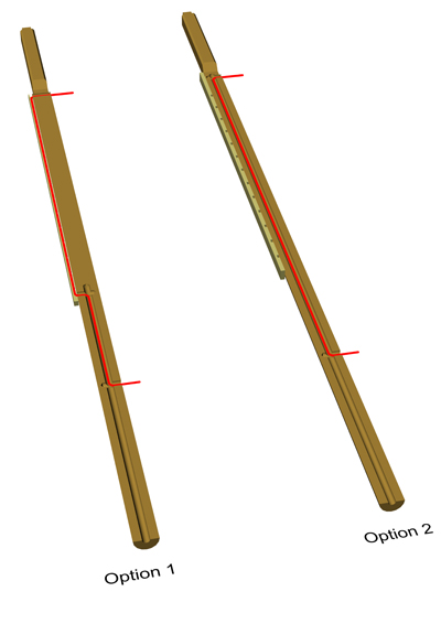

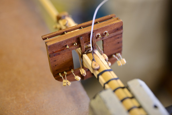

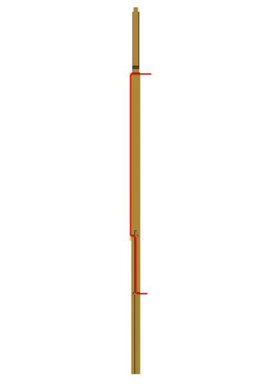

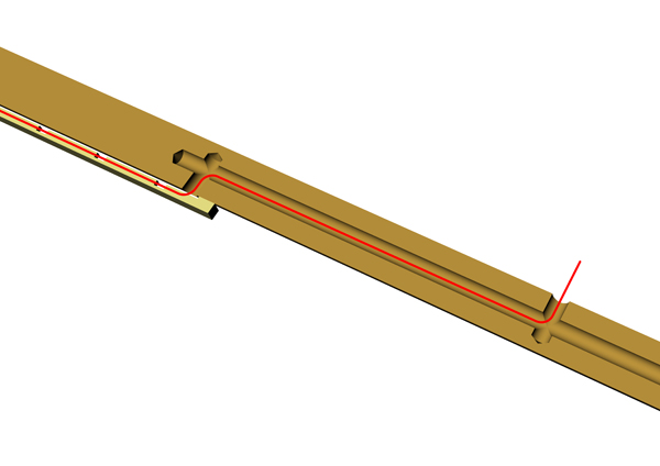

5.1 I think that the most difficult part of this exercise was getting the wires up the Main Mast.
First prize would be to cut a groove in a portion of the fore end of the main mast dowel before the bindings have been added. The groove will be covered later by the Rubbing Paunch. This will have to be planned for well ahead of time.
If, like me, your mast is complete, another method will have to be used.

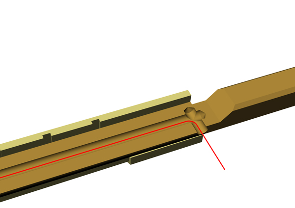

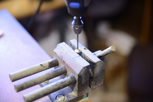

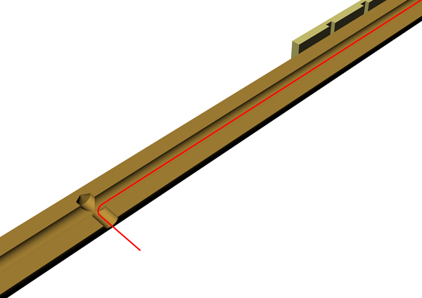

I think the easiest method is to cut a slot cut into the Rubbing Paunch (the 5x2mm strip on the front of the mast)
Either way, some drilling is going to be required. A Ø3mm hole will have to be drilled up the centre of the mast slightly past the Rubbing Paunch. (±150mm)

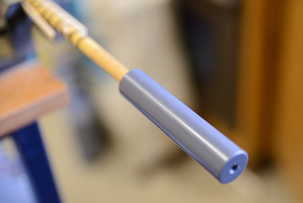

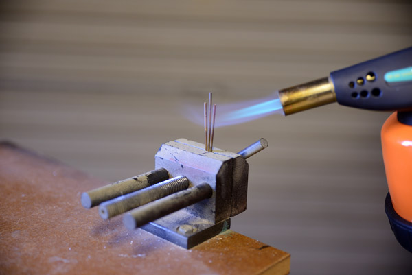

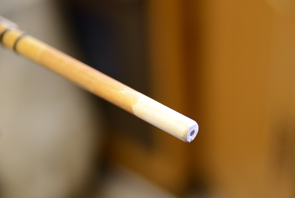

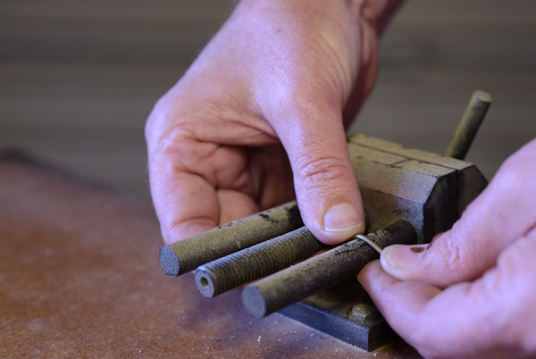

As I was unable to purchase an extra length drill bit, I made my own. I silver soldered a piece of Ø3mm brass tube to a Ø3mm Brad Point wood drill bit. I decided to use the Brad Point wood drill bit as it has self-cantering tip.

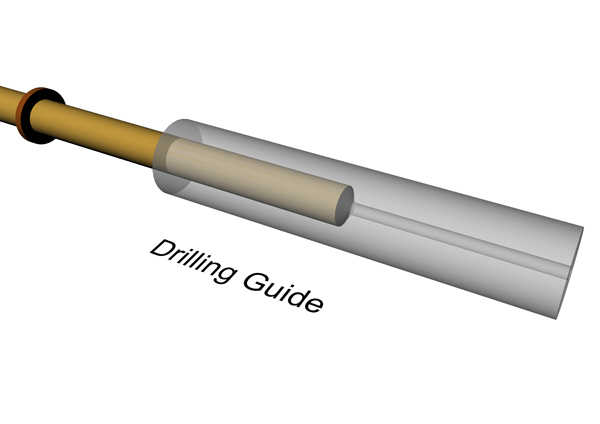

My next concern was how to keep the drill aligned. I made a drilling guide out of Ø20mm x 100mm Grey PVC. Fortunately, it fits into the chuck of my lathe. I drilled a Ø10mm hole about 50mm deep on one end and a Ø3mm hole on the other.
Theoretically this should start the drill bit perfectly centred and keep it going all the way up the mast.

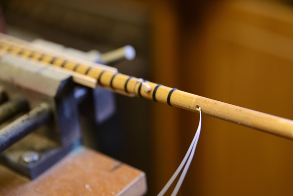

I used a hand drill to do the drilling and periodically removed it in order to expel the wood shavings.
Once the holes were drilled, I fed fishing line through from the top and pulled the wires through.
My confession.Blushing Blushing Blushing
I opted for the most difficult method, drilling the mast up to the fighting top. I followed my instructions to the tee. Made the drilling jig, drilled slowly, removed the shavings regularly, and fortunately, the drill broke through the mast just under the fighting top - exactly where I intended to run the wires!!!BigGrin BigGrin BigGrin
Well, after patting myself on the back and congratulating myself on a job well done - horror of all horrors, I had just bored a hole through the fore mast!!!Crying
Fortunately, the fore and main mast are the same diameter, I repeated the boring but the drill did not stay true. It broke through the mast about half way up. All is not lost though, I carefully removed the rubbing paunch, and cut a grove to hide the wires. I filled the holes in the mast and re stained them. The surgery is evident when looking close-up, but once all is completed, there is so much going on with the rigging and sails, it won't be noticed.
All’s well that ends well, that was 3 years ago and completely forgotten.

5.2 Modifying the Lantern
As the lanterns stem is solid, it will have to be replaced with a tube the enable access for the wires. The lanterns measured Ø1.5mm, but I was unable to find that size brass tube.
Fortunate I was able to purchase a Ø2mm Brass Tube with an ID suitable for the wires.
To start, cut the tube to length using the lanterns stems as a guide. I used my craft knife to cut them by rolling the tube across the bench, scoring the brass and then snapping it.
The brass tubes require annealing before bending them. I used a plumber’s torch, but I am sure a candle will work as well. Heat the brass until it changes colour. Be careful not to melt it.
Gently bend them around a suitable radius. The guide on my vice worked a treat.
Compare the new tubes radii with the existing and adjust accordingly.
Cut the stem off the base of the lantern and file it flat. Lightly punch a drilling mark with a centre punch and drill a Ø2mm hole through the lanterns base. The centre punch is to prevent the drill from wondering. i.e. keeping it on line.
Glue the new stems in place with epoxy or superglue. Let them protrude slightly as this makes for a mounting for the LED.
