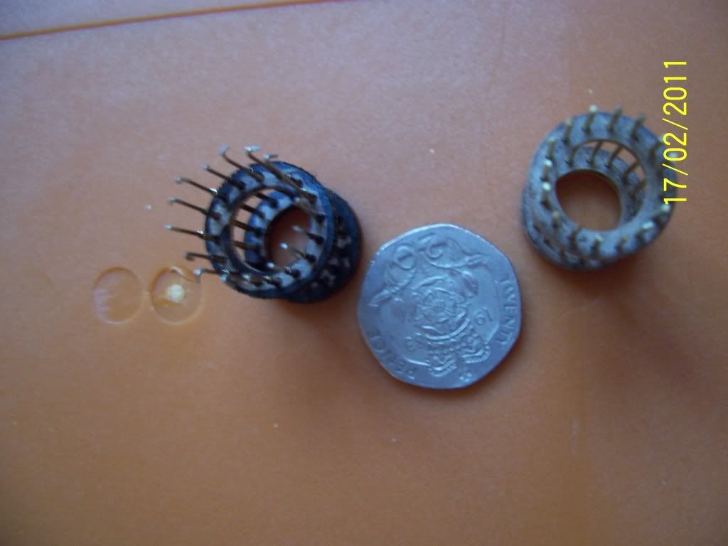

just waiting for the mast now

trial fit to masi

yes i did make them my self the rings are 16mm od x10mm id x2mm WALNUT,16 holes bored 0.8mm even spaced in the middle of the rings the pikes are0.8mmod x0.6 microx20mmlong brass tube ,heads are 0.4x25mmlong nicklesilver micro rods bent and flatten in vice then shaped i went for is the barb type look better small scale, right shape is 3 corner point- micro tube and rods i got at EXPO DRILLS & TOOLS ---THE VICTORY HAS 25 PIKES ON HER MAST i thougt thst was too many at the scale and the centre of the ring would drop out if you wish to go smaller you can get 0.5x0.3mmbrass tube and 0.3mmnickel silver,the reasion i went for nickel silveris its a soft metal very easy to flatten but with stifness
