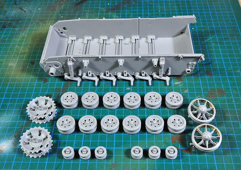

Hi guys. I just started my first Dragon model and chose this one.
It looks ugly but interesting all the same. For all of you who know Dragon kits this won't be a surprise but the instructions are a nightmare. Pieces are incorrectly numbered, they tell you to add pieces that you subsequently have to remove and they forget to add pieces that you need. Add to that the locations of many pieces are kind of vague and you have everything you need for a real headache. Having said that the actual engineering and the quality of the moulding is superb. So the lesson is take your time, test fit everything and keep your fingers crossed.
I have made progress.
The tub and wheels are done, and the start of the topside.
I'll be moving this along shortly. All comments are welcome.

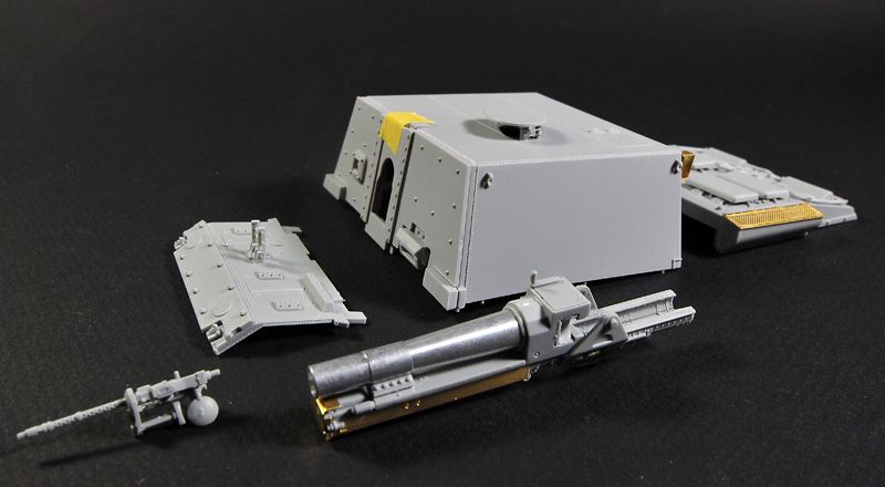

So a little more progress. Now that I understand the shortcomings in the instructions I am beginning to really enjoy this build.
I have left a little tape on the front of the turret since the armour panel is built to slide up and down with the gun elevation.
I've added these details just to show how good the basic model castings are.
More to come John

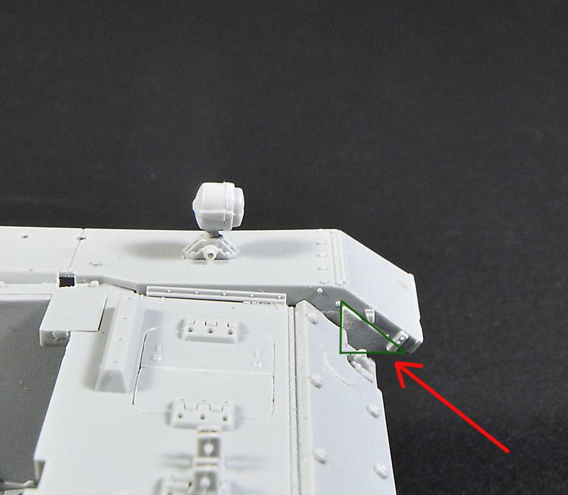

A little more progress on this. When I fitted the fenders I realised that they are moulded with a small triangular insert missing. This is no big deal but strange for a kit by this company. Anyway a little triangle cut from a spare sprue fixed the problem.
The interior will be completely concealed when finished but I thought I'd practise painting anyway.
Next step to close it all up.

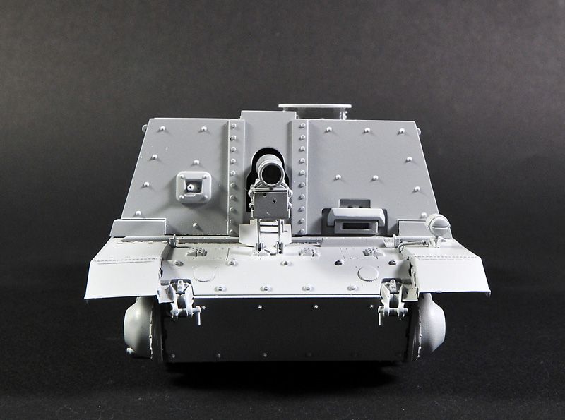

Don't you just love it when you get to this stage. All primed and ready to go.
So I'm ready to fire up the Air Brush. Fingers crossed

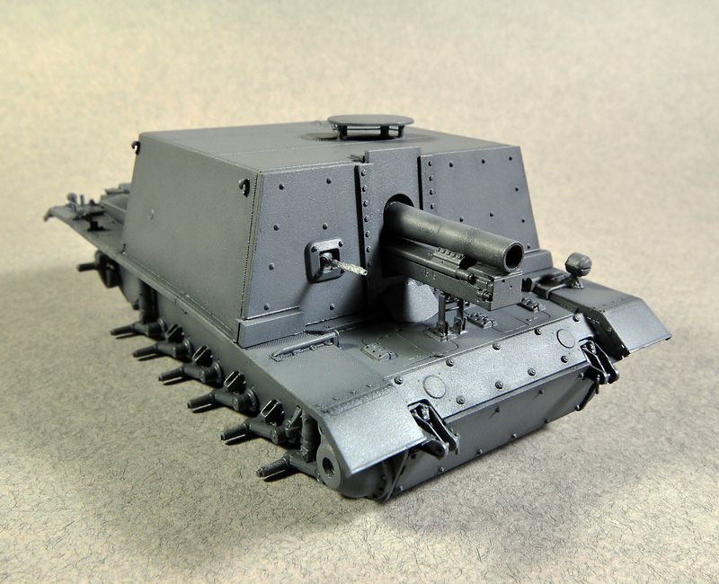

So I've started my favorite phase, painting. I start with a preshade in Tamiya flat black and then add some basic Tamiya German Grey. To start to define the form I then move onto a mix of Tamiya Dark Grey and about 15% Tamiya wooden deck tan. This creates a warm beige grey that contines the highlighting.
This gives a base to work on. I'll next add a light touch of Tamiya Light Grey with a little mix of Tamiya Flat Blue. This will add a cool complementary tone for the rest of the weathering to go over. I'll post my next steps soon
John

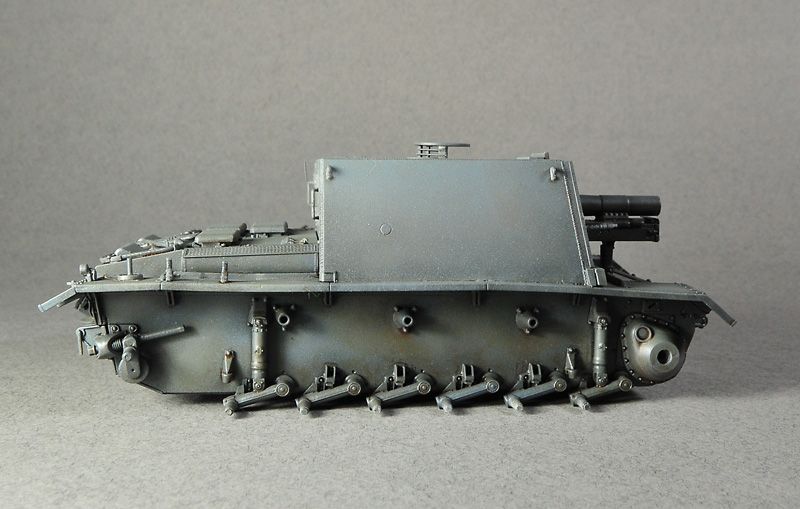

So I got through the next couple of steps since I'm going to be away for a few days I thought I'd post a couple of piccies.
I've added the cool blueish highlights. It's a little exaggerated for the moment but it will tone down in time. The storage lockers are not fixed yet.
The next stage is to apply an overall wash in Burnt Umber oils, thinned a lot with an odourless white spirit. This provides the final base colour over which decals and weathering will be applied.
The trick with this kind of wash is to apply it quite roughly all over the model and to leave it for about 2-3 hours so most of the white spirit evaporates. You can then take a dry cotton bud and remove or adjust the wash to taste. I like to keep an uneven finish to provide more colour modulation across the piece.
More to come when I get back.
