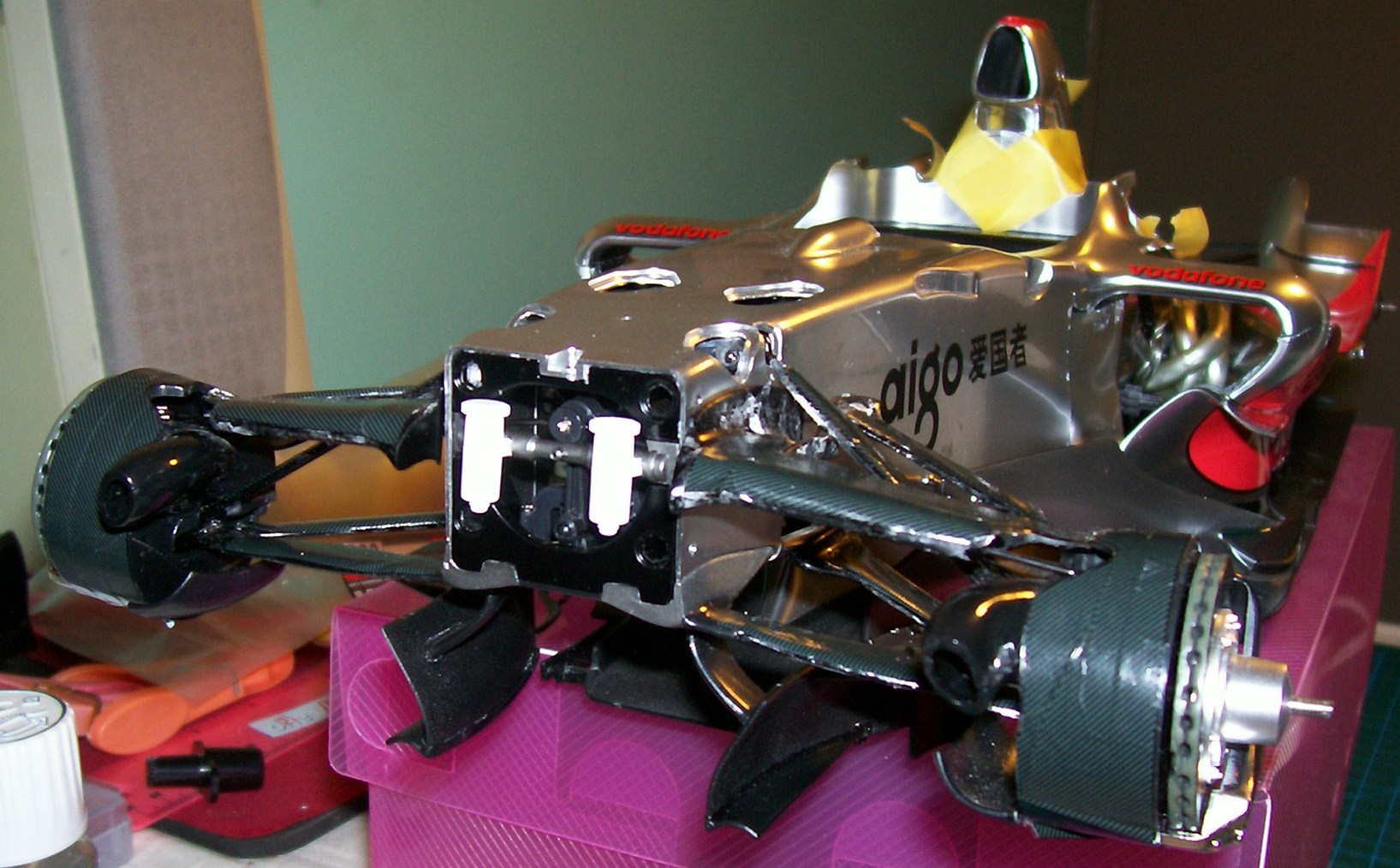

RobbieP
#12 Posted : 15 January 2013 20:55:21
Joined: 17/04/2012
Posts: 83
Points: 238
Location: Cornwall
the picture sort of shows you what I meant...could be a case of taking them off and ordering newMad

Warthog
#13 Posted : 15 January 2013 23:18:46
Joined: 20/03/2011
Posts: 2,356
Points: 7,122
Hi Robbie
I'm trying to understand what has gone wrong here Confused First i need to understand how you are applying the decals and secondly the amount of drying time that your giving the decals?? If your appliyng the decals with a solution like MicroSol or the revell one then I can't see how your getting the decals uplifting as they are from the picture..
Decals should be left to dry overnight and then the Klear applied evenly and sparingly to give a single coat at a time.. leave to dry and repeat... the next day if necessary.
I know we all have different degrees of expertise and to some this method of applying Klear can be daunting to some beginners but may I suggest that when you get your new decals (or remove the old ones in warm soapy water) and leave the suspension in its original black? I think you will be happier in the long run ( I'm not too fond of the decals myself to be honest)

RobbieP
#15 Posted : 16 January 2013 00:41:01
Joined: 17/04/2012
Posts: 83
Points: 238
Location: Cornwall
thanks for your comments Warty, what I did was apply by brush a coating of Klear and left it thinking the decals would adhere to it and follow the contours of the suspension then, after the application and about 5-10 mins I used warm water to detach the decals and applied them to the suspension...no Micro-Sol just Klear before hand and warm water for the decals. I think youre right, going back to the plain black would be better, I was much happier before I applied the decals and for my first attempt pleased with the results until then so, tomorrow its out with the warm soapy water and off they come. The ones on the rear suspension are fine does it mean I'll have to take them off too?Cryingthank you again for your support...its appreciatedBigGrin

Warthog
#16 Posted : 16 January 2013 19:28:00
Joined: 20/03/2011
Posts: 2,356
Points: 7,122
Hi Robbie
Ok I can see how you have become confused Crying Klear is NOT a setting solution. Klear is a polish to add a protective coating to the decal once it is dry. It's a floor polish but it is used by modellers too Aircraft Canopies and sometimes to protect the paint.
From what your saying is your using it as a setting solution rather than the MicroSol that some here are using.. Easy mistake to make my friend and it can be confusing to some who have never used it before.. Imagine it as a TOP COAT and nothing more.
If you do get new Decals then just apply as in Tomick's Official Build, Warm water and nothing else
