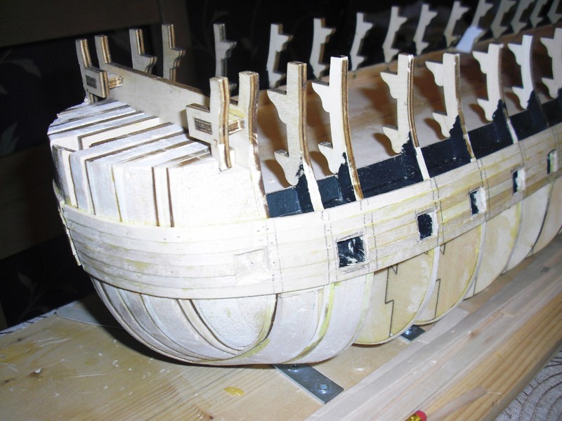

I know where to get the angle plates for the Jig but may I ask
what kind of board that is and what size is it and once I have the
angle brackets in place do I need to screw in to the keel to hold it in place or can I just slide model in place to hold it straight thank you
Ronald
#6 Posted : 24 December 2015 09:22:39
ronald305 wrote:
Nice Build Jig Mike
Ronald
Hi Ronald, buildboards I use are either shelving boards or MDF and are at least 15mm thick, preferably 20mm. The keel is not screwed to the brackets, it simply slides into place. Hope this helps....

thanks Alan it did so shelving boards will be the right length
Ronald
#8 Posted : 24 December 2015 17:52:23
Hi Ronald, my build board for the Victory is 1m long, 30cm wide and 20mm thick, made from MDF.

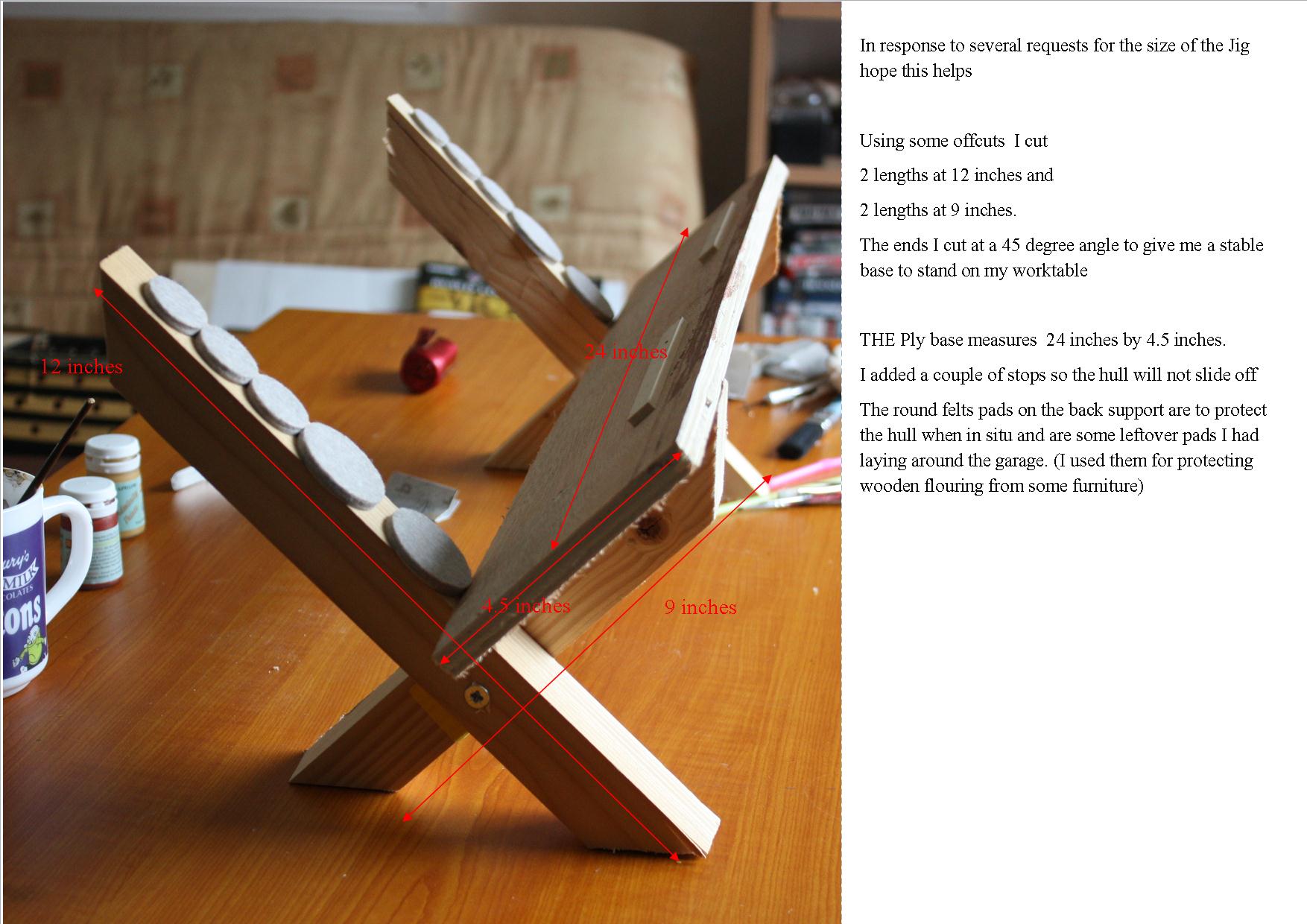

You may find this Jig useful at a later date, particularly when cutting out the gun ports on the Victory. I found that being able to work on the hull when it was at a 45 degree angle made the job easier
Gil

thanks Gil that is a neat jig could you give me the Dimensions for
your 45 degree support jig
Ronald
GilShapley
#12 Posted : 26 December 2015 17:08:07
Joined: 10/10/2010
Posts: 691
Points: 2,136
Location: Dorset
Picture attached

Hi Mike
would you know the spacing between the angle brackets or do I just measure the keel thickness once I get the first pack
Ronald
#14 Posted : 14 January 2016 10:16:01
Yes just use the keel thickness to determine the bracket gap

Hi Tony
I just started mine yesterday trying to make my building jig as I'm writing this, trying to find out the distance between each bracket
Ronald
#18 Posted : 09 February 2016 20:26:32
Its fairly straight forward.
Pencil in a centre line onto your baseboard.
Offer up the false keel from the victory kit to your baseboard then line up your brackets each side ensuring that none of them cover the slots for the ribs.
Hope it goes well for you BigGrin and post up some pictures of your build should you have any issues.
