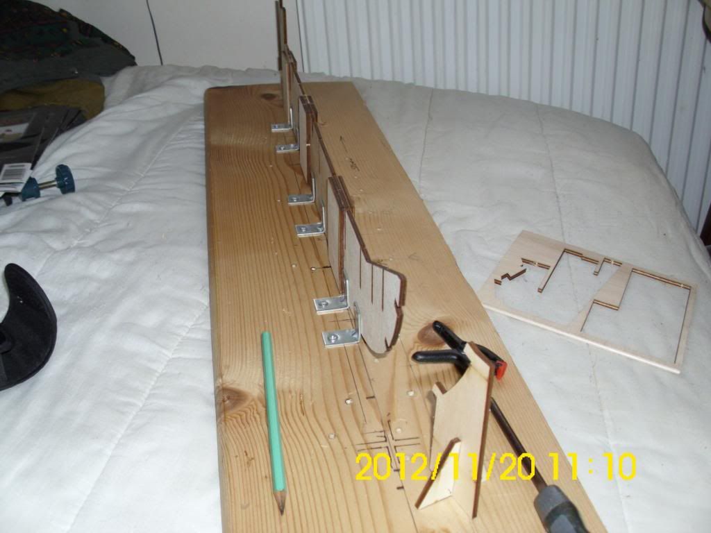

Looking at the picture of Jonny's launch build, perhaps I might suggest that the problem people are having with the launch is trying to bend parallel sided planks around a curved surface. The planks do need to be shaped so they fit comfortably onto the ribs which in turn need to be chamfered just enough to accept the planks.
For those reading this topic and who haven't started planking yet, you might like to look at launch construction
