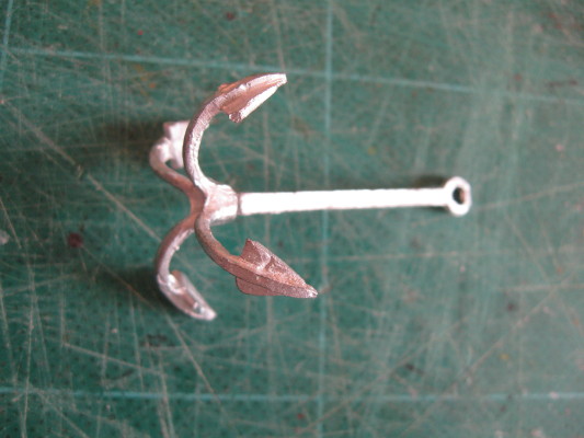

Grapnel anchor

#4 Posted : 21 June 2010 15:20:49
Its just to show Sted's what a grapnel anchor looks like

Cheers for the pic T, - I see it has FOUR sides and not, as I first thought, three.
Most helpful.
ThumpUp
@ Capt Birdseye: the anchor supplied with the kit is 'representative' - I have since scoured the internet and my local angling shop for something similar and whilst I have found such delights as 'Admiralty' style anchors, Modern, cast ones, and even sand anchors, I'll be damned if I can find a Grapnel one. As for my local angling shop, the dweeb that mans the counter, once he could pull himself away from contemplating a paper bag, thought I was taking the mick when I asked if they stocked a grapnel and was far too up his own... to even bother asking any further questions.. I hate that kind of attitude.

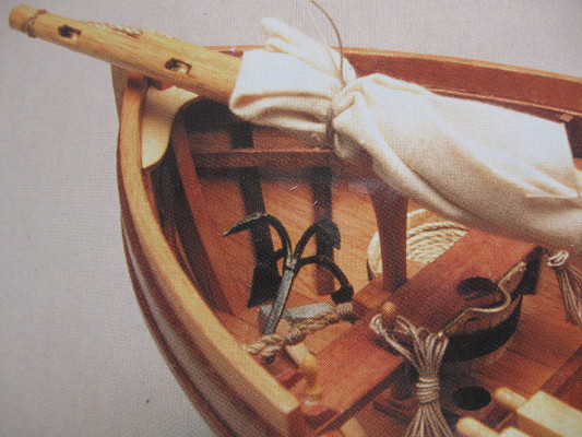

Anchor photos from the content of the Panart 1/16 Launch kit
Hoover attached the following image(s):
