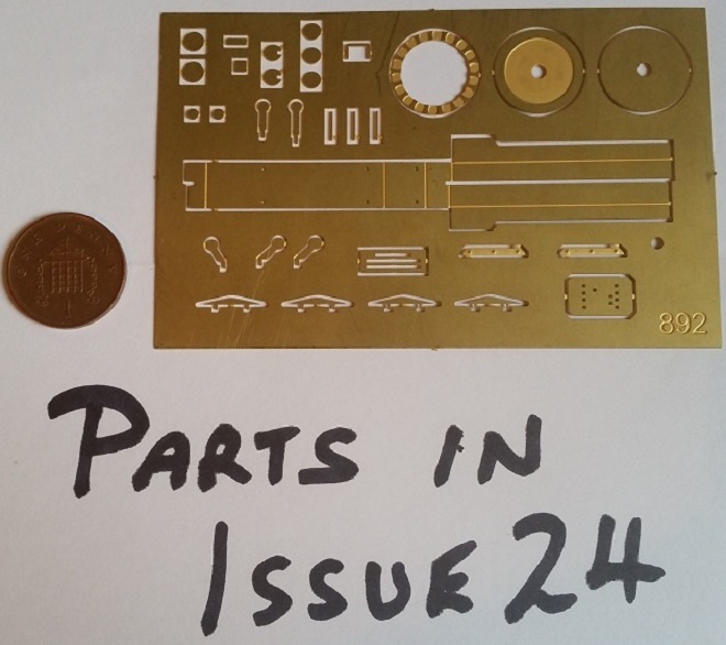

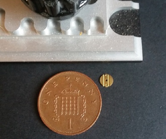

Here`s the parts supplied with issue 24.Pic 1
The only part used in this session is the box section. All other parts are from previous issues that have been stored until now or parts previously made up to a certain point, that now need enhancement.

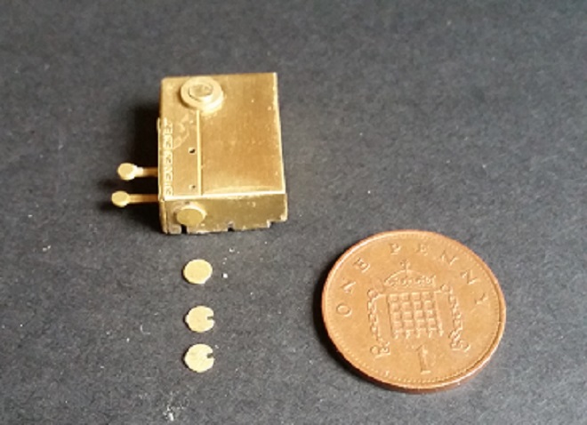

The pic below shows the parts used in the following section of the build.
The unmade box section is from issue 24 parts and the rest from previous issues.Pic 2

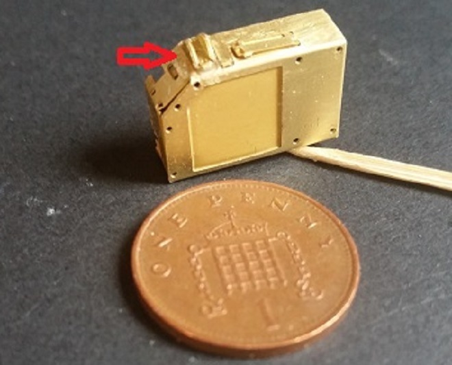

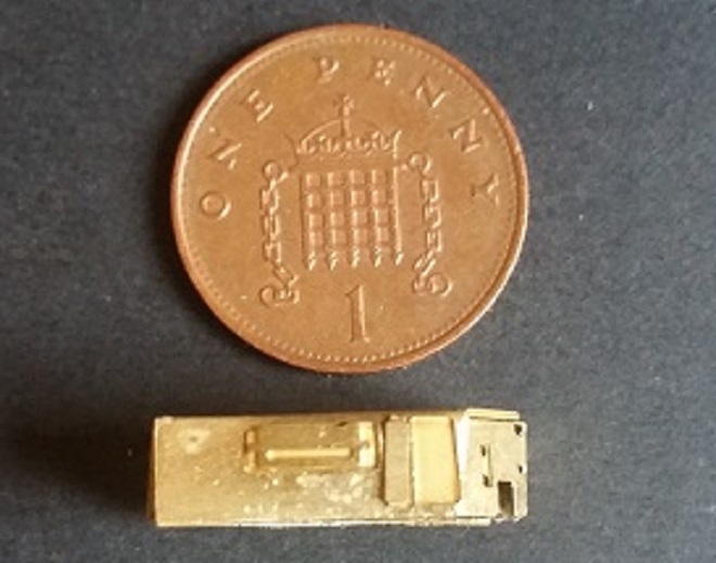

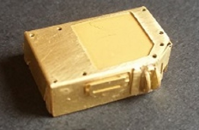

So here we go with the next box section.

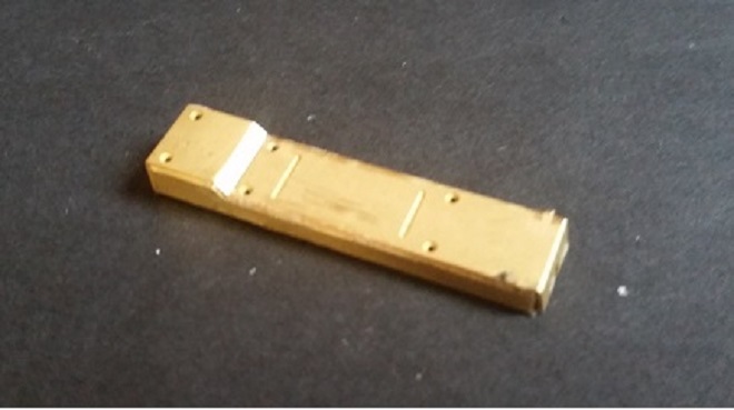

The blank in the "Hold and Fold" for the first bend.
This is a long box and the hold and fold makes it so much easier to get these bends straight along the whole length.Pic 1
Then the resultant bend.Pic 2

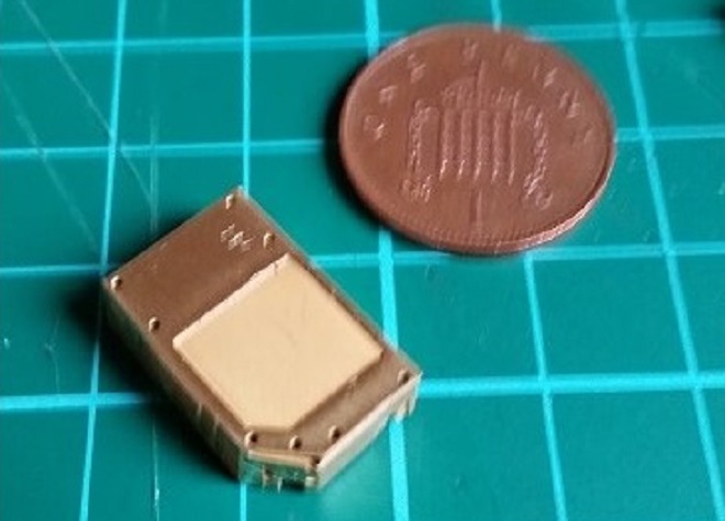

This is then repeated on the other side, to produce this result.Pic 3

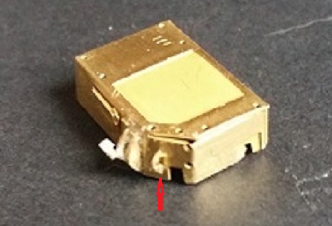

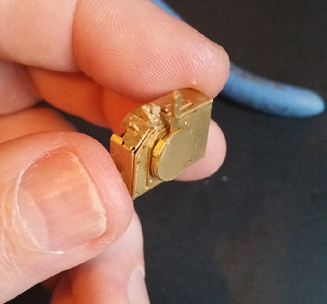

The last faces of this box section all come from the last remaining section of brass to be bent and fitted.
To aid in the accuracy of the bends in the last side of this box, I bent one face at a time and stuck in place, leaving it to set after every stage.
Here`s the end result.Pic 4
That`s the box section finished for now, it`s put away for future enhancement.

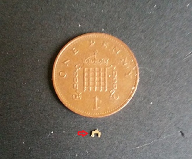

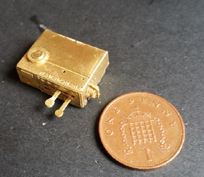

Think you will be seriously impressed when you see what the etch can make in this instance. Cool Cool Cool
26 parts added to a box section made earlier and it still fits on a penny, well 2mm overhang. LOL LOL

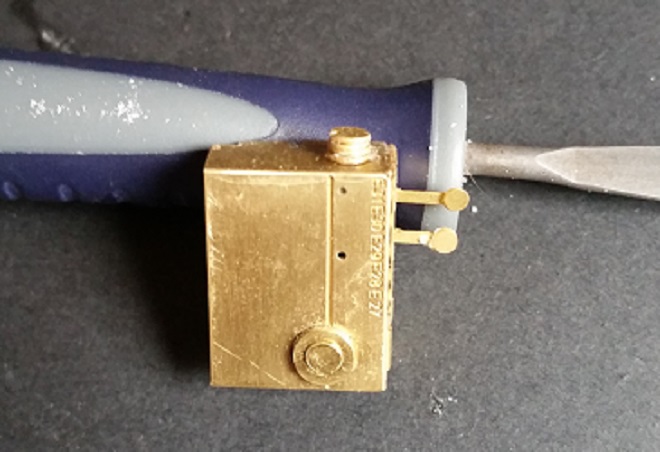

Here`s the next stage in my "Stuka" build.

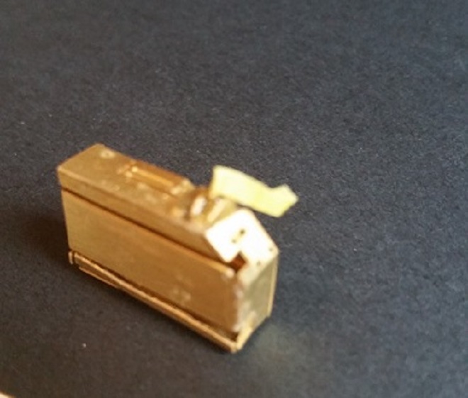

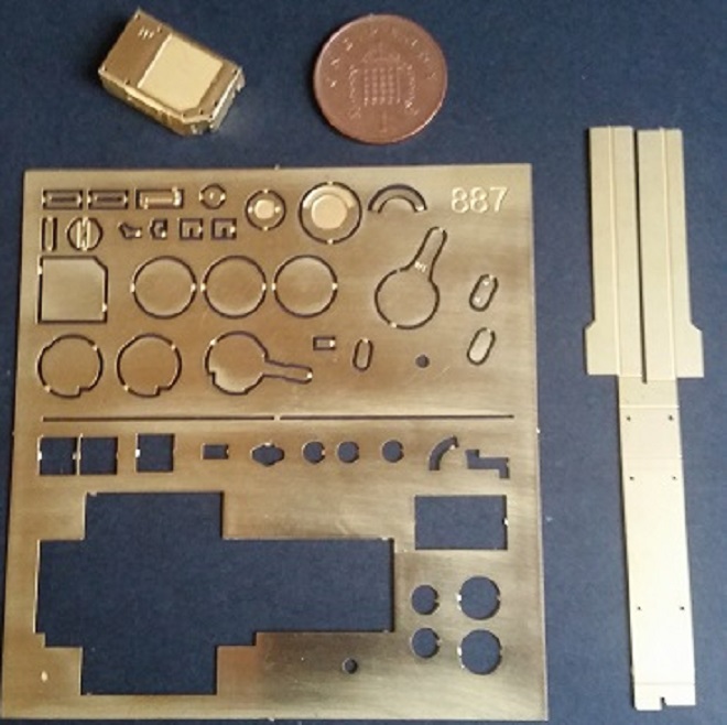

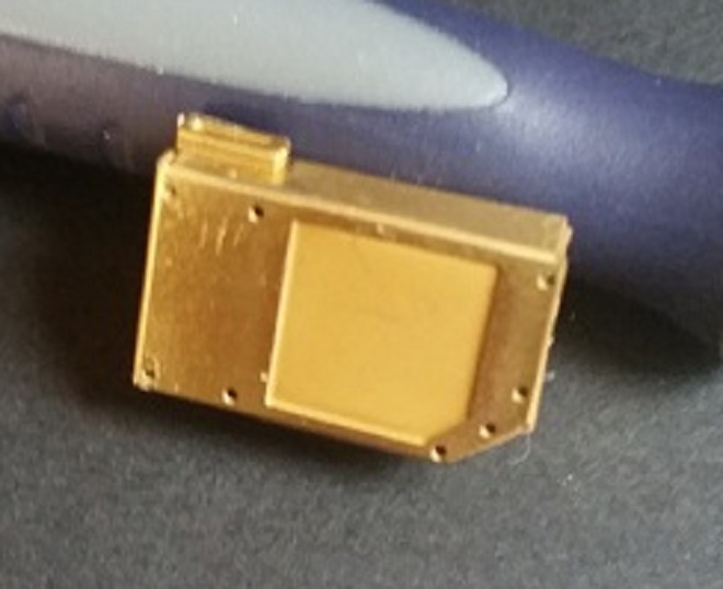

Firstly recover the part shown below, as this is the next enhancement work to be done.Pic 1
The enhancement parts are left over after the completion of issue 23, fret number 887.
As before cut the parts from the fret and remove any burs with a miniature file.

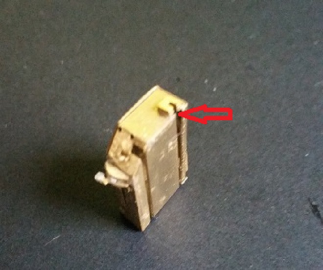

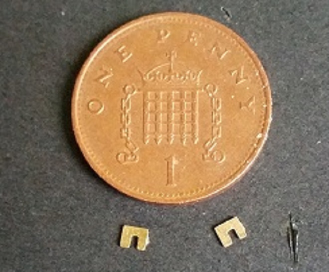

The first two parts are identical and are stuck together before being stuck to the main box section.Pic 2-3
The following parts are facia enhancement pieces and they are stuck into their relevant etched places as shown.Pic 4-5

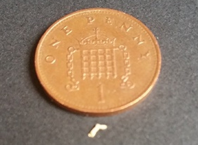

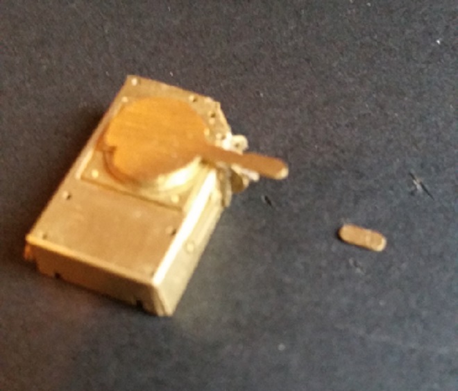

The next part, other than being seriously small, also needed to be bent at right angles in two places.CryingPic 6
My smallest pliers, still made it impossible to fully bend this part as required. So I bent the part as much as I could using the pliers I have and then used the smallest finger on the "Hold and Fold" to finish the bends by inverting the part over the finger and pinched in both sides at the same time with pliers. This is the result.Pic 7-9
Having managed to get the bends required, the part is stuck in it`s place, on the last etched space next to the last parts fitted.Pic 10-11

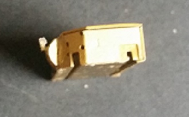

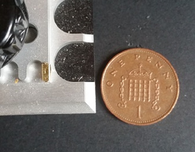

Ok, so with that small issue out of the way, things took a turn for the "WORST".
The next part took an age to fit and included at least an hour (over four sessions)recovering said part from those dreaded "Carpet Gremlins".
Don`t mind telling you, I spat my dummy, cursed, swore (Wifey went to kitchen at this point)refrained from kicking the cat as all three of them followed Wifey to the kitchen.
This is the start of the madness, "THE PART".Pic 12
The part is a switch and has to be fitted inside the last piece fitted to the box.
After several miserable failed attempts, I put everything away and worked on a plan. Pliers and tweezers failed and caused the loss of the part four times as it flew across the room.
Finally came up with this solution.

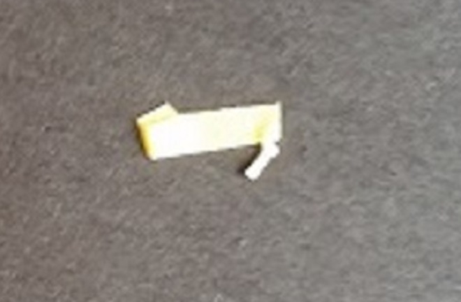

Low tack masking tape, cut in a thin strip. Folded the ends over to ease the task of removing the tape later.Pic 13
Stuck the part in place and left to set.Pic 14
Having given this bit plenty of time to set, removed the tape.Pic 15
Problem over, moved onto the next part.

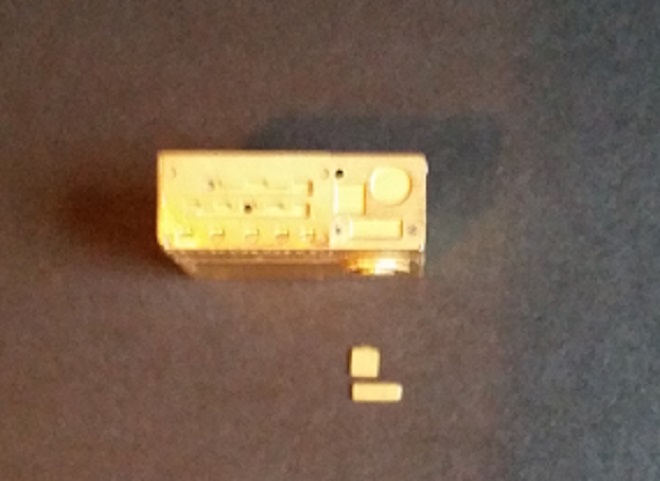

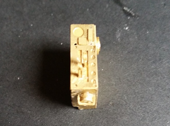

Still very small, but fixed to a point that was easily accessible, to the right of the switch.Pic 16-17
Again we have two identical parts to be stuck together, which are then stuck in place.(Pic not good, but part can be seen on the top right hand corner).Pic 18-19

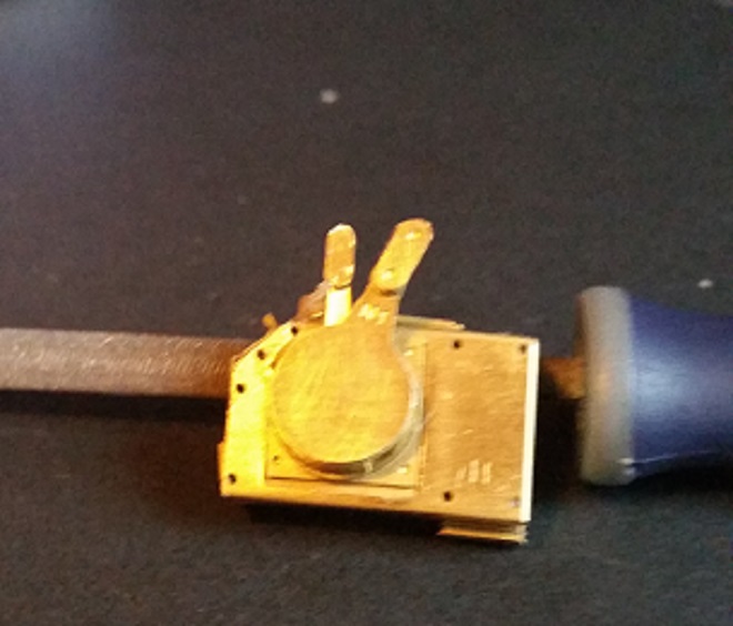

Attention now turns to the main face of the box.
Numerous parts are now stacked one on the other to produce two control levers.
The following pics show the sequence of parts.
A couple of plain discs have been omitted from the sequence of pics, but you have to take care in the orientation of the rest of the parts.
(Clearly shown in the instructions)Pic 20-24
Just having a lever in this scale is not enough for this kit, even the lver handles get enhanced.Pic 25-26
This is what we have when the first lever is fitted.Pic 27
After the addition of a couple of plain discs, the second lever is fitted and the handle enhanced.Pic 28
The outer face of the second lever is then enhanced with three more parts added to this base plate.Pic 29
With the last three parts added you get this final result.Pic 30

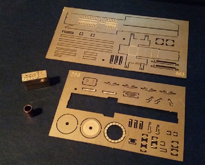

So to start, here`s the parts supplied with issue 25.Pic 1
We add to those parts, the remaining parts from issue 24 and one of the previously made parts.Pic 2

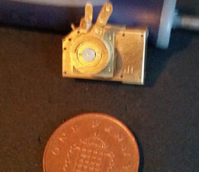

In the first pic two parts are added into there relative etched places and the second pic shows two levers added to the same face of the unit.Pic 3-4
The levers then have additional parts added to give them more shape, then the first of four parts are added to the end of the box to produce a control dial.Pic 5-6
A further three parts are then added to the end dial.Pic 7
This gives the following result.Pic 8
Final part is then added the end dial to give it it`s final shape.Pic 9-10
So here`s a pic of the unit as finished to this point of the build.Pic 11

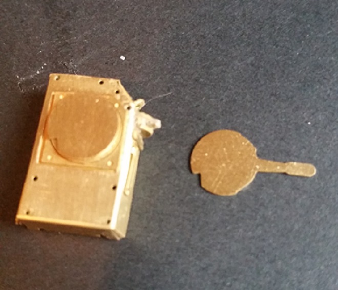

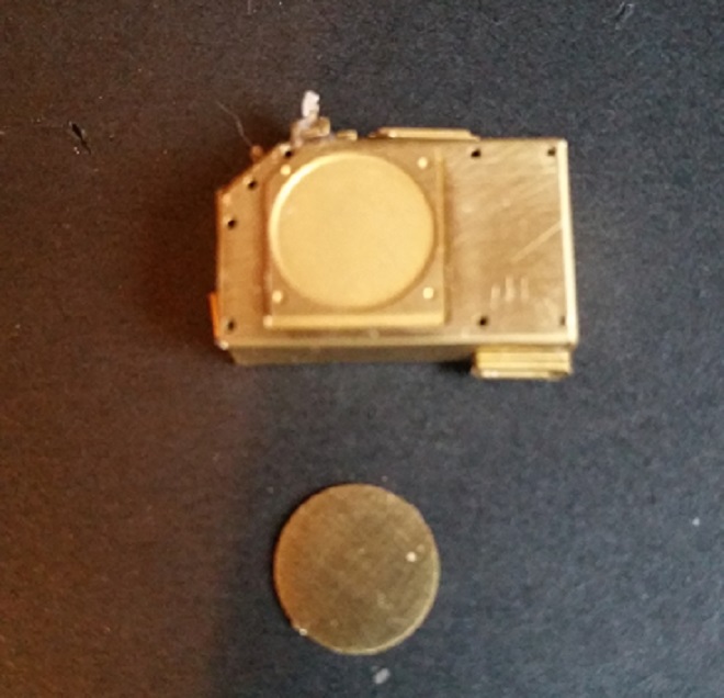

Now at first glance I could not see the relevance of the next part of the build and it wasn`t until I looked as far forward as issue 115 that it became apparent.
Won`t bore you with the detail at this point suffice to say it fits on the above unit, just much later on. Not sure why so much later, but will stick to the instructions.
Here`s the parts.Pic 12
The three parts are stacked and glued one on the other, in the order shown to produce the following result.Pic 13
